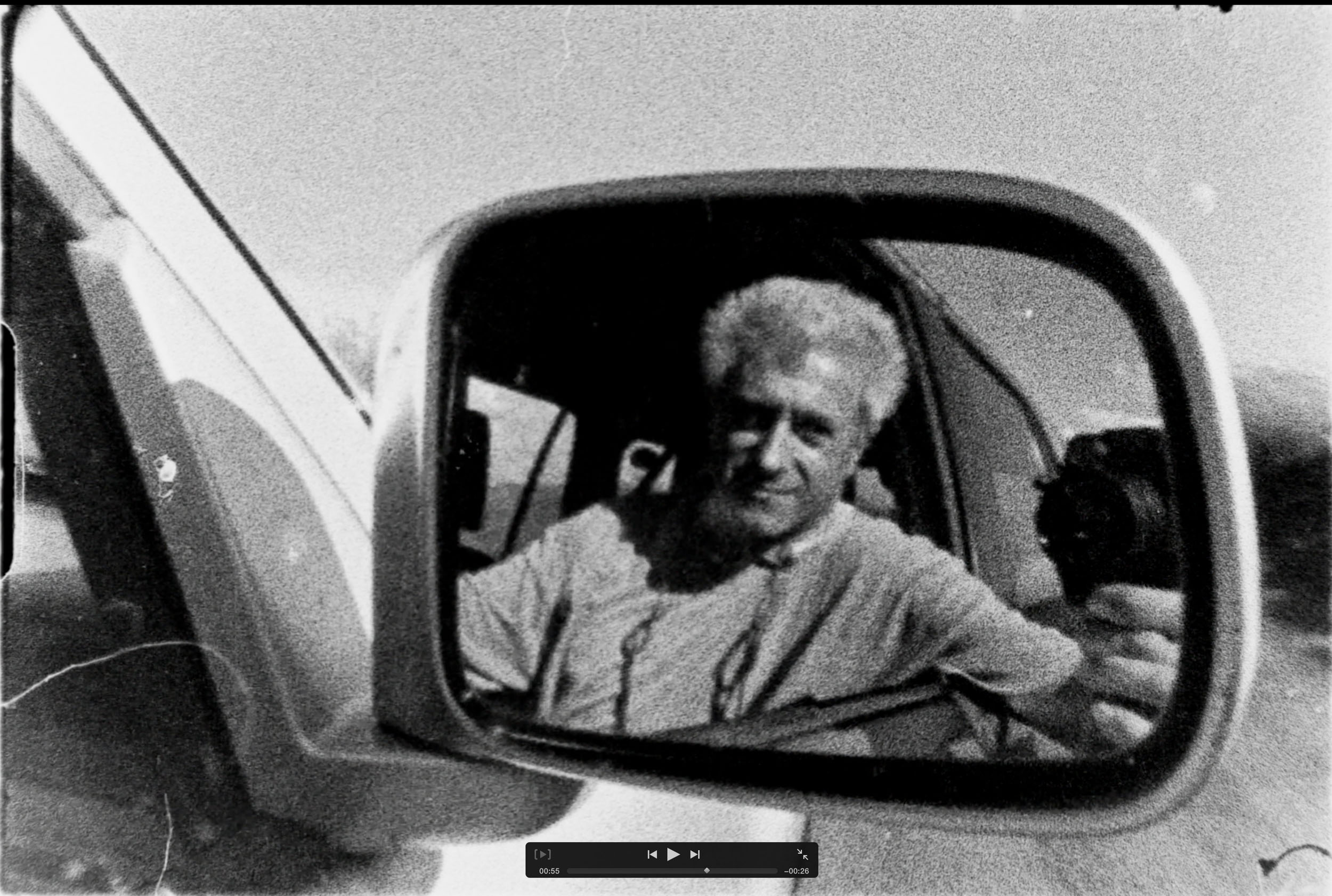

Hello there analogue souls.
I just bought some B&W Agfa Scala 200X super 8mm reversal film. Made some tests developing it as a negative, and was quite happy with the results. Does anyone has more experience with the film, especially how to get a finer grain from it?
200 ASA is a lot for the tiniest film on the planet. The film is B&W reversal but I don't have the reversal kit and thus I am not getting the best of it. If anyone knows the recipe for the reversal bath, or a better negative developer for it, I would appreciate it very much.
