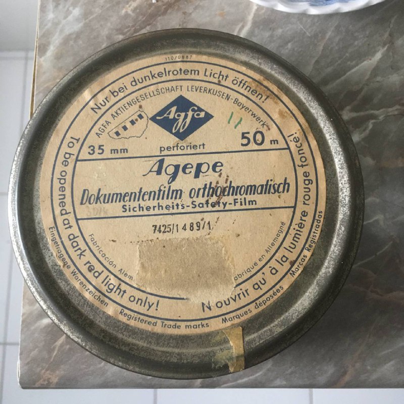

Hello dear colleagues,
A esteemed friend brought me this reel. (God bless him)
In fact, I am confused about the way to deal with this - method of photography. There is no ISO number written
And the development method as well. I have a recipe for a microfilm developer, but I do not know if it will be suitable or not? .
Yes, I know perfectly well that I have to do several experiments and tests, but that reel is currently in the mail and it will take some time to reach me due to the pressure of work at the Postal Authority during the festive season.
So I wanted to discuss with my respected colleagues about this so that I could get a starting point from which to start the experiments and tests.
- It is said that this film is the legal father of the film (Arista), but I actually do not know what is the truth of this because I have no experience with the genetics of the categories of films.
If any of you have any suggestions I would be very, very grateful.
They are intended for a workflow with fixed pameters, without using a lightmeter..Such films are typically offered without stating their sensitivity. Being extremely contrasty this depends on the developer and with orthochromatic, or even spectrally unsentized on the light source.

@mohmad khatab: I think what @AgX means is that this film is not meant to be used for pictorial purposes.
Yes.
I thought the term Dokumenten Film already said enough.
These films typically were used to reproduce texts or graphics. The were used by amateurs too, for recording documents or to make graphics from continuos tone negatives. The latter is something completely negated here at Apug. In this case the document film yields an interpostive, which is used to expose onto photographic paper directly, or by means of copying onto a second document film a internegative is made.

These films were not made for amateurs, not for pictorial use, not for continuous tones, but for a commercial, fixed set/up for repetitive use. The commercial client then by trial could find out how to expose and develop.
For a later film Agfa published even a broshure for amateur use.

Could this be the same Agfa film used by Holden and Weichert back about the same time as the use-by date on the can? Look up the H&W developer.
In a recent thread here Alan Johnson has compounded a 2-bath for this sort of film.
https://www.photrio.com/forum/threads/developer-for-aviphot-pan-200.182434/
Don't be put off by the title and start reading from post #100. He uses Metol and CD4
I have been using Imagelink HQ ISO25 with a developer made with 0.5ml Rodinal and 0.5ml of HC110 (syrup) in 250ml water semi stand 40 mins.

Dilute developer with somewhat lower pH than normal might work for very high contrast films though there'll be significant speed loss. I got very nice results out of Micrat Orto, an orthochromatic document film sold by Astrum, by using dilute Kalogen with some sodium citrate. My Flickr stream has some examples in case you want to look at.

I don't know if they are the same. You can ask Dmitriy and find out. By the way, Mikrat is a very slow speed film (ISO 3) and as such not useful for handheld photography. But it's a very fine grain and high resolution film that gave me very nice results in both negative and positive development. It gets scratched very easily and hence needs to be handled carefully.

@mohmad khatab: don't mistake me, I don't know if this Agfa film is similar to Micrat as I've never used the Agfa film. You're on your own here as far as Agfa film is concerned and I don't want to give you false hopes. Dilute developer with reduced pH is something you can try and find out if it works.
Mohmad Khatab, Thank you for the unearned flattery. I am merely a reporter of old (H&W) history and recent (Alan Johnson). I was impressed with the huge enlargements possible of Alan's sample pics. Images that would cover a wall have no grain to my (poor) sight. The gradation is pictorial enough for me with this class of film. As the saying goes "Horses for courses"
Try my brew with some slow fine grain film with what you have. I hope it works well for you but we are talking v old film and don't ever forget these films demand superior lenses and an extraordinary hand control or you waste your time.
