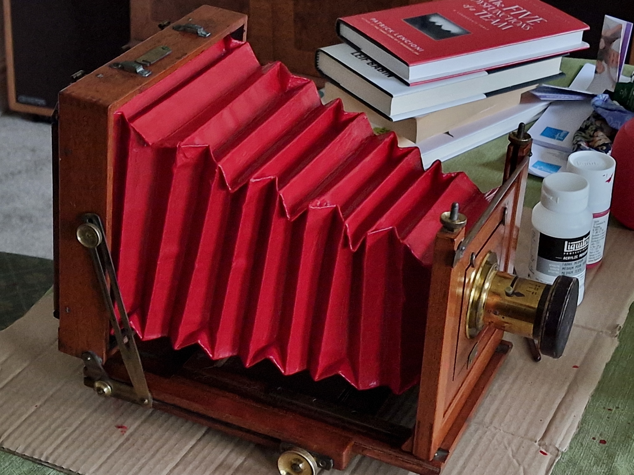

By the way, I learnt a lesson using acrylic paint this last week.
Make sure you add a fabric medium to an acrylic paint (unless it is a fabric specific one) otherwise when it dries you will lose some flexibility and the paint will crack
=1 on Mr Lynch BTW. Great resource and very knowledgeable.
I have an Isolette II and it is fabulous. I stick a Watameter on it if I need very accurate distance otherwise I just figure it out.
Here's my half plate with one coat of black, three coats of acrylic and a final coat of acrylic with the fabric medium. Only after the last coat did it stop cracking.
