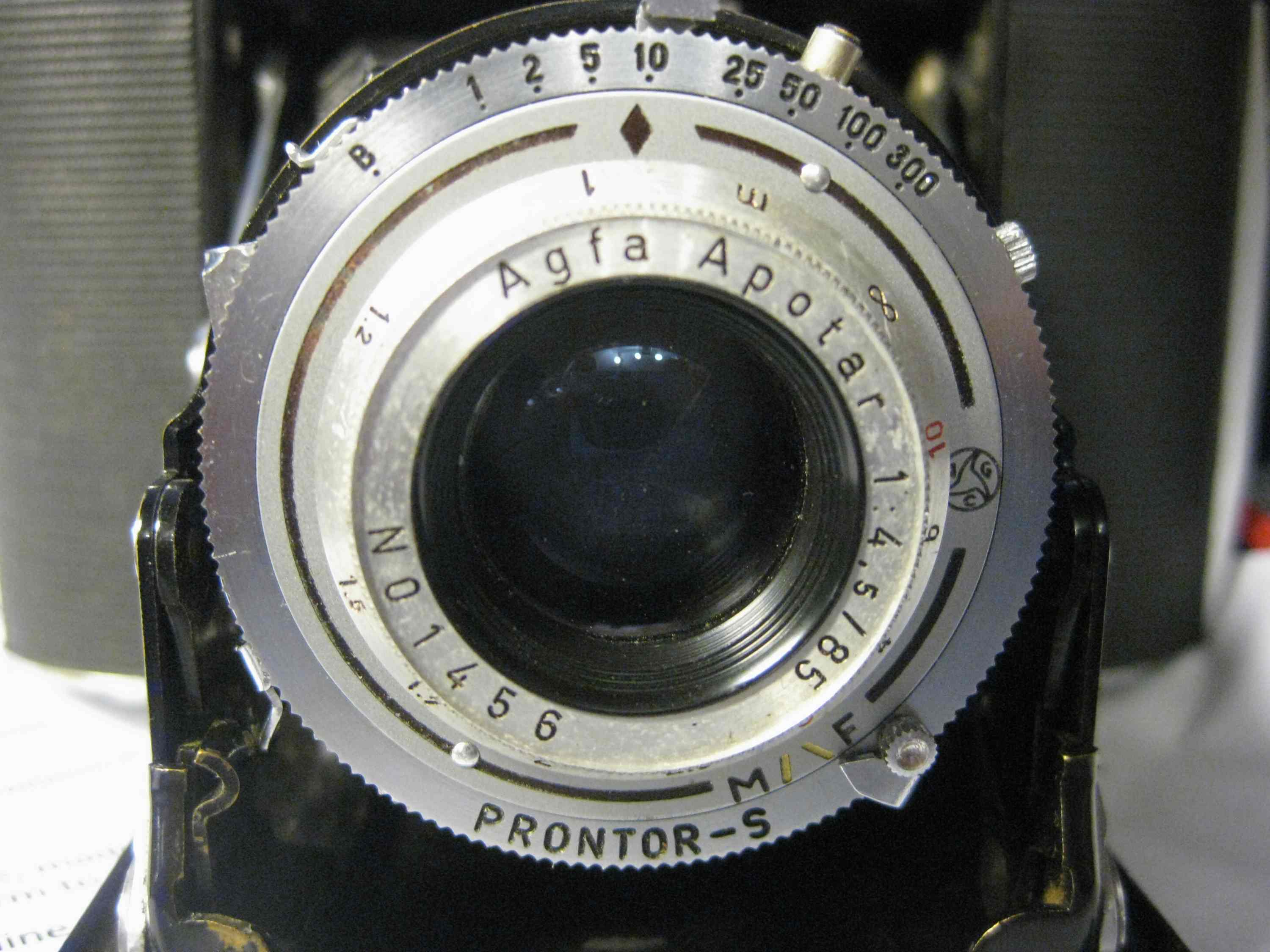

Hi All,
My first post here.
I was given an Agfa Isolette III some years ago and I though it was time to get it back into action. This is my first camera repair.
I have managed to strip, clean and reassemble the shutter mechanism and get it operational with the shutter running about 1/3 stop slow so no real problems. Originally the shutter could not fully operate and the focus was very stiff. Green grease issue.
But I have a lack of understanding regarding the timer operation and I can’t tell if it’s not working properly or not.
In the manual the operation is (with names in brackets added by me):
1) Cock the shutter.
2) Turn lever 6 (timer lever) to the left as far as it will go. Shifting lever 9 (synchro lever) must be put implicitly on “RED X”
3) Press exposure trigger in usual way.
What I have found is to set the timer with stressing the timer gears, I have to cock the shutter, set the synchro on to M cock the timer, set synchro back to X and fire the shutter.
If I leave the synchro on X setting the timer forces the gears. If I cock the timer on M and fire the shutter the timer does not operate and the shutter fires immediately.
When it was apart I noted that there is a lever in the timer mechanism that is affected by the synchro lever and this would disengage the timer gears and allow a smooth cocking.
So could some one with more experience than me explain how to use the timer?
ps: shone a light into the bellows, they lit up like a Christmas tree. Next task new bellows.
Kind regards
Andy

The advice in general these days is not to try to use the self-timer in most old round shutters. It's far more prone to problem than the main shutter operation, and if it jams there's a risk of damaging other parts trying to get it to fire the shutter (and the shutter is unusable while the timer is jammed).

What Donald said. Just assume that any old camera that has a self timer doesn't have a self timer. I've seen numerous shutters hang up when using the self timer, and a few never came back into operation.

Hi,
Thank you for your responses.
I made a mistake in my original post. Part should read
"What I have found is to set the timer without stressing the timer gears, I have to cock the shutter, set the synchro on to M cock the timer, set synchro back to X and fire the shutter."
Donald, Momas: I understand what you are saying and have thought to to myself "Do I need the timer?". My personal task it to get the camera working so I'm trying to find out how the timer should be operated so that I can check if it is working correctly. Regarding whether I use it or not, I'm hoping that some one with experience of using the Isolette would be able to explain in more detail than the manual. At the moment I can get the timer to work well but my method does not agree with the manual.

There were a number of different shutters on various Isolette models and price points. A photo of yours would surely help.

Good point.
It's the PRONTOR-S with the Agfa Apotar 1:4.5 / 85
Sorry a bit big.
Thanks
Andy

Hi Ray,
Thank you for your comments, I have a set of his bellows in front of me waiting for me to fit them. I chose black so it wouldn't attract attention although the coloured ones do look good.
He also has a good video on YouTube
Well presented history of his adventure in cameras.
In my original post I was after finding how the timer was supposed to work as the manual I have, and ones on the web are for a different shutter.
Do you know how the one in the photo should work?
