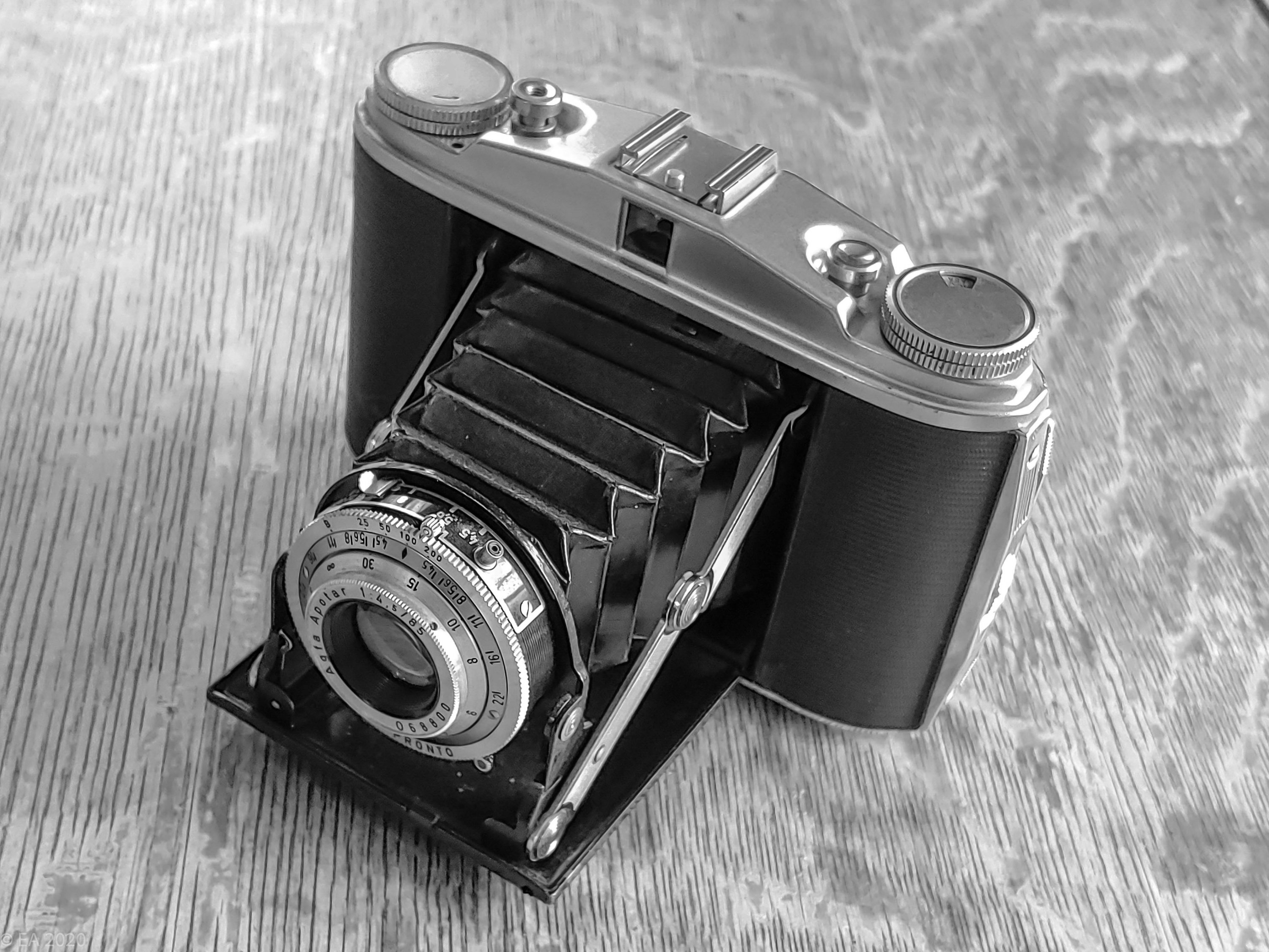

...the 1/100 sec exposure time seems reliable for hand-held work, 1/50 sec there were too many failures.
Donald Qualls
Jan 19, 2005
12,544
North Carolina
Nice. Cameras in that class (scale focus 6x6 folders) always seem to do better than they look like they should.
If 1/50 isn't working right, it might be time to learn to clean shutters.

I have an Agfa Isolette II (not sure of the difference to the I) and I shoot this camera often with excellent results. Very portable MF camera.
pentaxuser
May 9, 2005
20,388
Daventry, No
I have the Isolette I and mine doesn't have a 1/100th speed. It is a speed that would be useful but there we are. So I assume that the OP has another version from the I
One of the slight drawbacks with the I is that it only has three shutter speeds 1/25th; 1/50th and 1/200th but it's manageable in most circumstances. It belongs to an era when in N Europe at least and given the film speeds of the day a 1/100th might have been a more useful speed

The Speedex and Isolette are essentially the same camera (Ansco and Agfa have some history together), differences are mainly cosmetic.
pentaxuser
May 9, 2005
20,388
Daventry, No
Not wishing to be pedantic but for the sake of accuracy all I can say is that judging from the photo of the Speedex in question, it has a whole range of speeds that my Isolette I lacks
pentaxuser
Donald Qualls
Jan 19, 2005
12,544
North Carolina
There were different versions of both cameras, both over time and over price points. Both were sold with at least three shutter choices (perhaps not always at the same time), a couple different lenses (triplet and Tessar type, usually), and at times with two different maximum apertures (f/6.3 or f/4.5, usually). The Speedex, at least, also had a "Junior" version that was fixed focus, I and B speeds, and choice of f/11 or f/16.

Neil Grant
Jan 30, 2007
555
area 76
...it's an Isolette 3 with an uncoupled rangefinder (so, not really scale-focus). The lens as a 75mm 'tessar' type. I have an alternative 'neg' of the wheel barrow still-life taken on a Mamiya C 330 with 105mm 'heliar' - and the sharpness and contrast of the two lenses is very similar.

Okay, uncoupled RF -- equivalent to a Mess Ikonta, then.

I've been a folder fanatic since 1966. Keep in mind that the shutter speeds are probably slow, so that your 1/50 may actually be 1/25. The shutters are usually pretty easy to clean; lots of online resources to help you with that. I had the shutter spring replaced on one of mine and all the speeds are accurate and consistent - but exactly one stop slow.
I use mine for subjects more than 15 feet away, anything closer and I use a 35 SLR. In fact lately I've been using my folders as they were originally used; focus set at the red dot, aperture also at the red dot, shutter speed adjusted as needed, modest enlargements. Beautiful results.

You might look at the lens bed to find where the shutter release actually happens. Usually there is a tab there. For example, on the Ansco Speedex above, the release and the black tab are at about 8 o'clock. The mechanics of the shutter buttons on the top of the main body on folders are often not smooth. Using the release right at the shutter is often much smoother, allowing for slower speeds without blur.

the shutter release on the lens is located as you describe but completely inaccessible. I've found it's important to do things 'just-so' with my Isolette 3 or a frame will be lost because the 'blocking device' becomes activated. Don't advance the film until the last moment, don't push the shutter until it's cocked. Then be sure to hold the shutter release down long enough for the 'blocking' to be activated. You just can't rush this camera.
