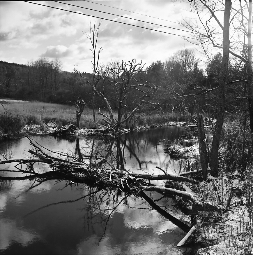

Ok so I shot another roll through my Yashica Mat on Saturday and developed it last night. No marks from the backing paper are present. I guess it was the camera.
Here is a scan of one of the frames.
