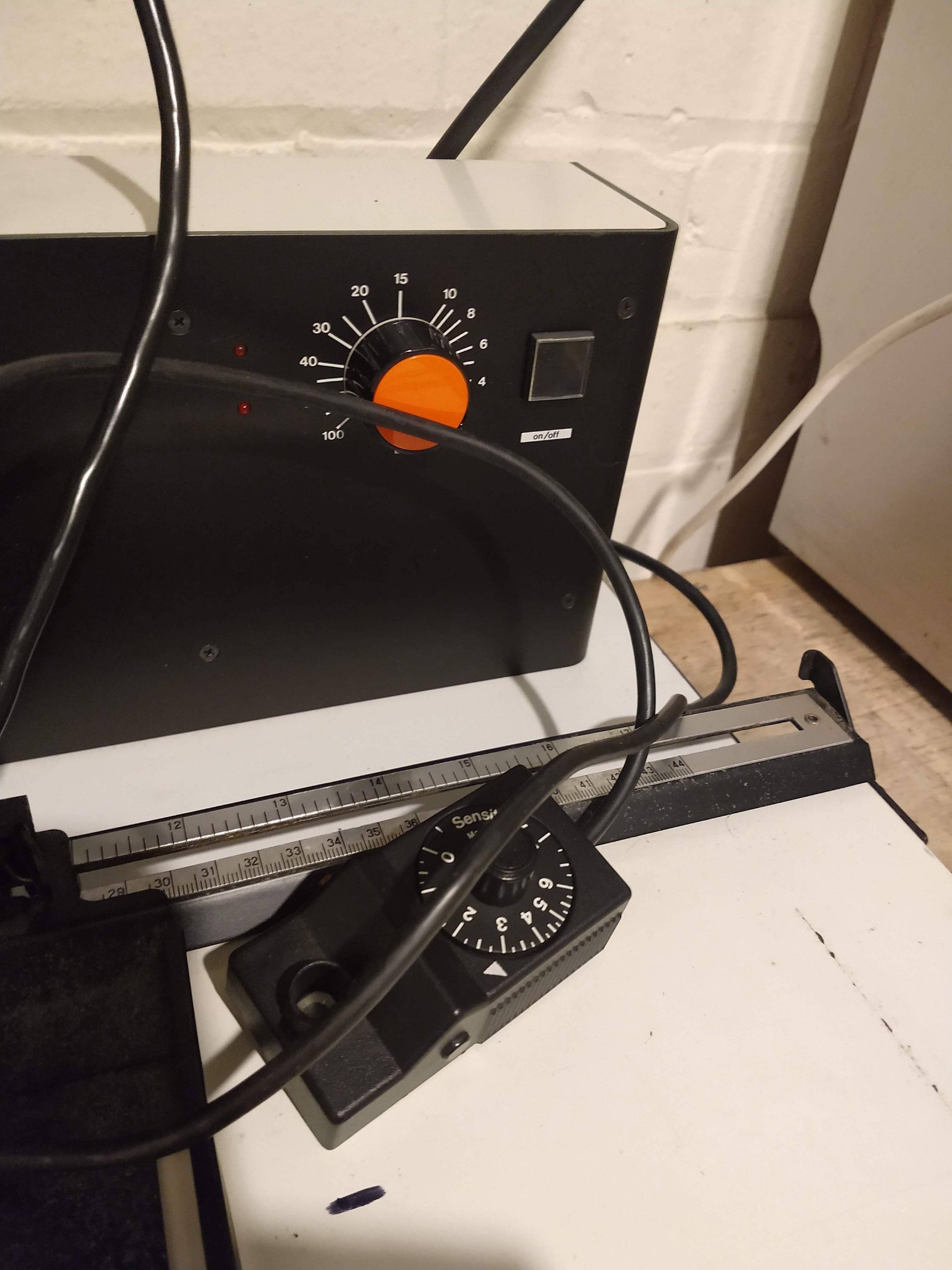

Hey all,
My very first post!!! Hoping someone with experience can help.
I've just bought one of these enlargers (its literally a direct copy of the durst m605) and cannot make sense of the in built timer - when i turn it on and dial in nothing happens, just stays on. (picture attached of the timer)
I've also tried plugging the enlarger 3 pin plug directly in my digital timer in to the wall, it makes a noise like its powering the enlarger but no light comes on.
So far i'm stuck with the idea of manually turning it off/on.

It was made for Agfa by Durst so isn't a copy, there's some instructions online somewhere I say them about 18 months ago. Is teh bulb working at all ?

I've just bought one of these enlargers [Agfa C66] (its literally a direct copy of the durst m605)
It is not, instead it is a version of the M 606 built specially for Agfa incorporating a metering timer and being added a vacuum plate. Agfa intended it for commercial use in the graphic industry.
It is intended to be used only running on that metering timer. Maybe here your issue is situated.

Thanks agX.
Do you have any idea how to use it? Can it be modified to use another timer?

I never came one across and the manual is not clear to me on its use. But there should be a focusing setting. In this setting one should be able to use the unit on an external, classic timer.
In worst case one needs to open its electrical casing and sort things out.

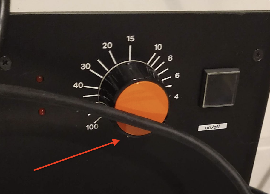

I own an external hauck timer, and a smaller enlarger. The problem with this one is that even though it has a focus mode, the switch is electrical and not mechanical, so it doesn't really work to power it through an external timer as is. That's why I think the easiest way would be to somehow wire the transformer directly to the bulb bypassing the PCB, and then use an external timer. I don't think anyone would be interested in buying it separately since this system was made for Agfa's own kind of printing system, and probably not for private use.
Canta_loupe
Dec 21, 2022
Sweden
I was instructed by a kind internet denizen to connect these wires (pink and white going into a triac) to eachother, and it seems to have done the job. So I'll leave this here for posterity. Also, if anyone wants to to this themselves, I advise you to be careful with the screws on the casing since they're made of very soft metal, I wore two of them out, luckily they were only fixing the components inside so I could still open the thing up.

... when i turn it on and dial in nothing happens, just stays on. (picture attached of the timer)
Did you wait for the exposure sequence to finish. Looks like you have it set to 100 Exposure Units. That could be a very long time before it turns off. Try 4 exposure units and see how long it stay on.
