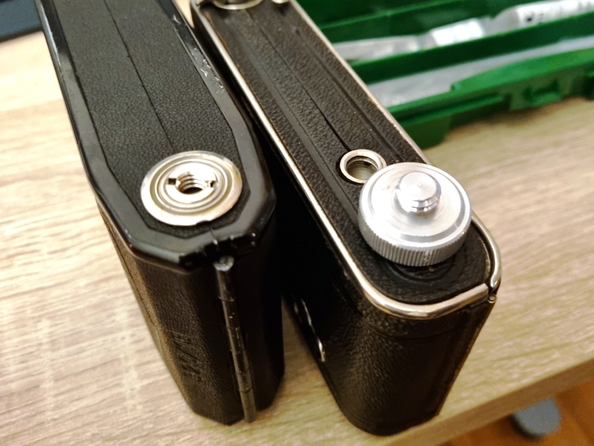

Very interesting. My pre-war Zeiss ikon accepts the "modern" style 3/8" to 1/4" adapter (left), the 1930 Voigtländer (right) doesn´t. But both accept the vintage style adapter shown in the second picture. That´s the way to go.
And - there is no metric tripod mount, but obviously two different 3/8" tripod threads with slightly different pitch.
