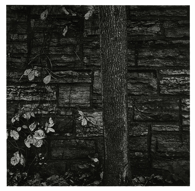

I have heard on more than one occasion that Agfa APX films and Pyrocat (or PMK, ABC, W2D2, Precysol, whatever pyro there is) is a no-no.
The other day I developed a couple of rolls of APX 100 and in the past I've developed some APX 400 in Pyrocat-MC and Pyrocat-HD successfully. Nice stain, fantastic grain, and sharp like crazy.
Is there any substance to the claim of those films not suiting pyro developers? If yes, why?
Print from negs attached to view that results indeed are normal.
Thanks for your insight,
- Thomas

What was the reason given, if any? Pyrocat MC stain is a bit hard to see on films that have very low base fog, but it's there. If there's any doubt, you can check by making a print on grade 2 paper and another on VC paper with no printing filtration. Based on what I see, you certainly did no harm by using the combination.

I love APX 100 in Pyrocat HD. Lovely stain, great midtones and highlights that in check. I go 2+2+100 for 13 min. 21C.

Emil - I shoot Agfa at an EI of 100, I develop using a semi stand technique, or minimal agitation (agitate full first minute, then once ever three minutes; two inversions) for 16 minutes at 70*F at the 1+1+100 dilution. In fact it works so well I wish I had more, but I'm also very satisfied with my results with Tri-X and FP4, so I won't be lamenting the demise of APX 100 or 400 any time soon.
