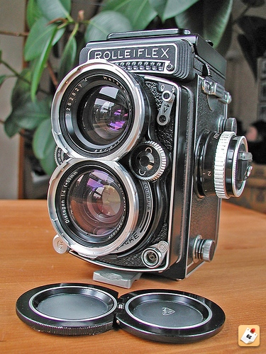

Yes, 120. Shot with this:
That's a great camera system. I have never shot 6x6 but perhaps some day I will bite the bullet. I love the view from the top into the frame.
