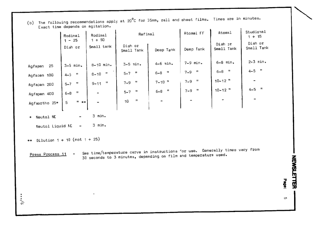

This is a screen shot of part of a page from Ilford Film Chemical Manual probably from 1995 judging by its printing code.
Sorry about the format of above post. The ID-11 time probably a good guide to D-76.
Thanks john_s I can figure something out from there

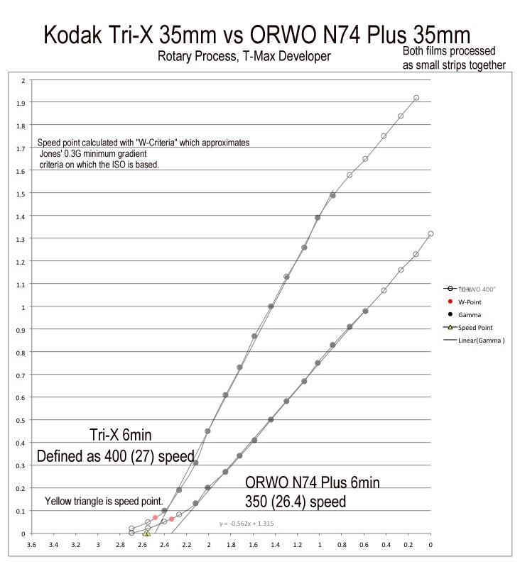

For example my latest spreadsheet does calculate speed on a data-set, however, perhaps the more useful number is the little 0.562. I know that the film processed under those conditions will not print well in my darkroom unless I crank up the magenta.
BTW I have the spreadsheet do a least-squares regression on the first 12 points higher than 0.1. It does this automatically; I try to make it as objective as I can.
