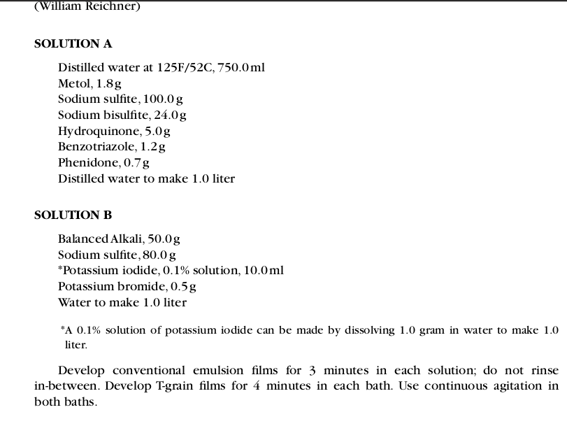

- Take a picture of this roll on the basis that it is ISO 6 and develop it according to the double formula that I attached to you in the pictures, it will produce you images that are balanced to a large extent,,
