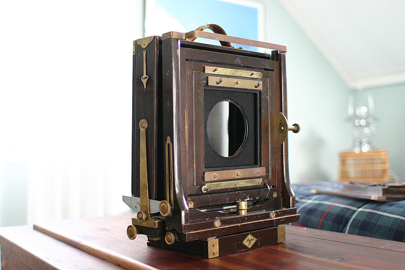

If you would like detailed pictures, let me know what you need and I'll take them for you. Mine is original right down to the red leather bellows as far as I know. To make the photos correct for you, maybe you could take small pic's of what you want and I'll do the same views in hi-res digital.
The cutouts in the corners help to vent air when opening and closing the camera and also allow for some ventilation to remove moisture etc. Personally I'd leave then there.

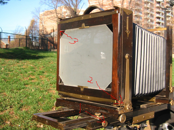

This (there was a url link here which no longer exists) might help.

Thanks for the photo!
1. is missing and someone put a screw arrangement that is going to damage the extension over time. I would like to know whats in there so i can find something good to improvise with.
2. they removed the inner brass friction piece and put some big aluminum piece instead. I guess they were trying to increase the amount of tilt. I guess I can live with it but it looks gastly.
3. I would like to chisel these out and put a full GG in. Many people like to use the entire surface of the GG and you can deaal with trapped air simply by lifting the back a bit when you compress it.
The cutouts are also useful for checking if there is any physical vignetting from the lens/bellows. I would recommend leaving them.
