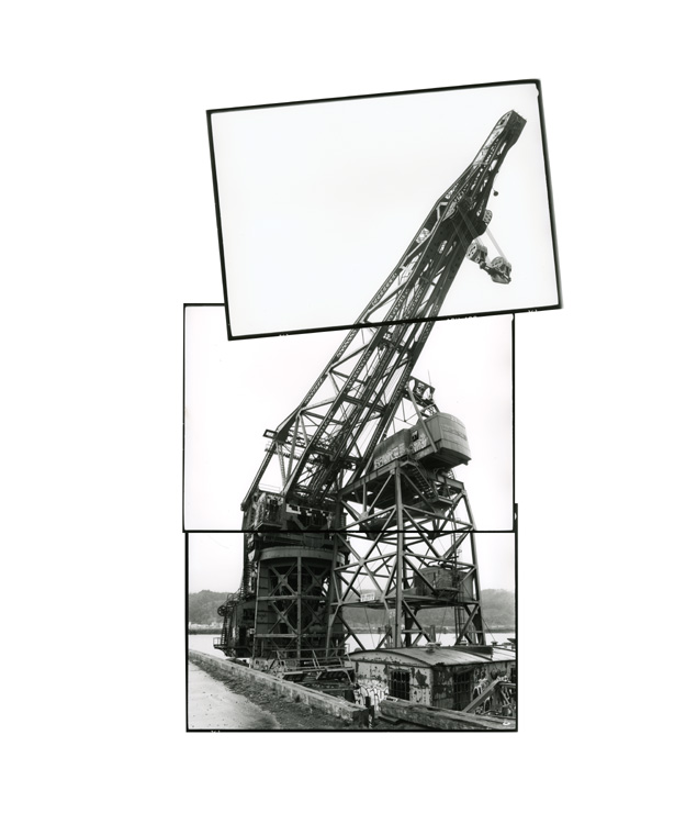

Here is my APX400 developing data (120 format, printing with condensor enlarger on Agfa MCC and MCP):
Acufine 1:0, standard agitation: 7.5m at 70 degrees F
This is good for EI640 in diffuse light and ~EI1000 in direct sunlight (the attached photos werre made with the APX400/Acufine combination).
For Pyrocat HD 1:1:100, I expose at EI250 and develop for 11m at 70 degrees F with standard agitation.
--Philip.
