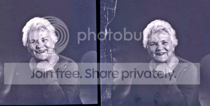

It's been a while but I finally have a chance to try "cooking" some new paper before using to see if it "aged" and altered it's contrast and it appears to me that it does.
The one on the right was"cooked" before using.
Both pictures were cut from the same sheet of Ilford Multi-Grade glossy paper and both were pre-flashed for 12 seconds.Used a 180mm lens at f 8 for one second camera exposure,the developed in Dektol 8:1 for 4 minutes.
It appears the"cooked" one lost some speed as well as has lower contrast.
The"cooking" consists of sealing the paper in a can and roasting in a toaster oven at 90 degrees for 2 hours.
My first try was at 250 degrees(I forgot gelatin melts at about 97 degrees) LOL! Needless to say it wasn't successful....
Still having a great time learning to use in-camera paper negatives.
Let me know what you think.....
