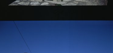

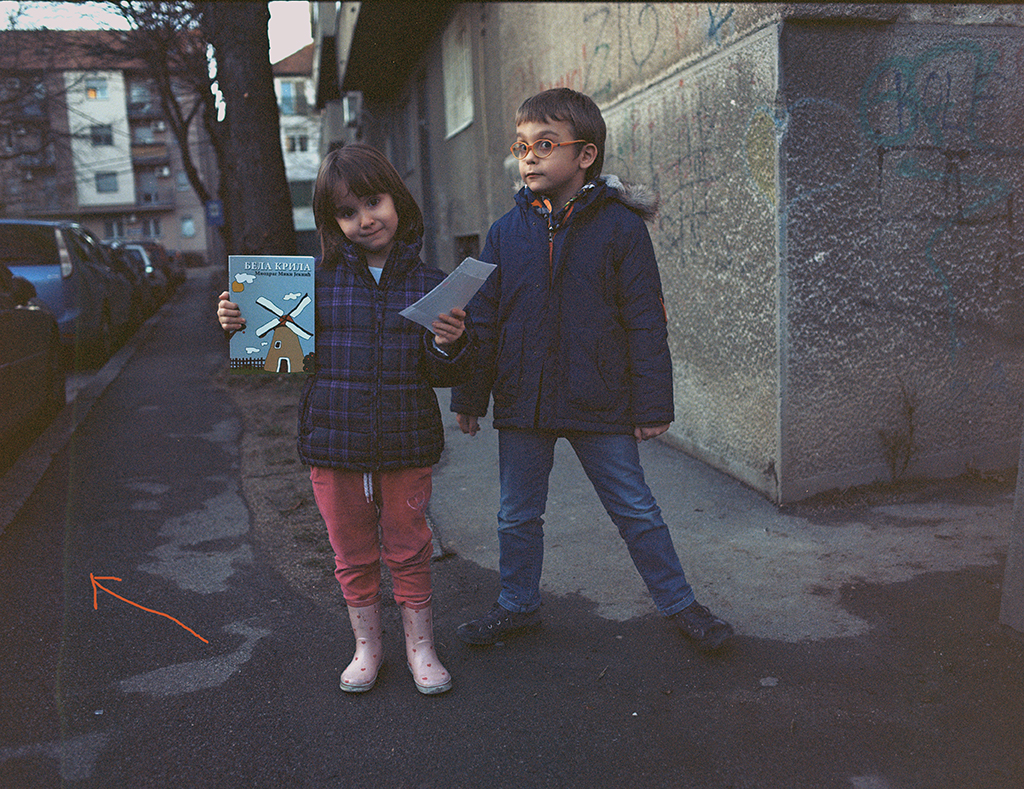

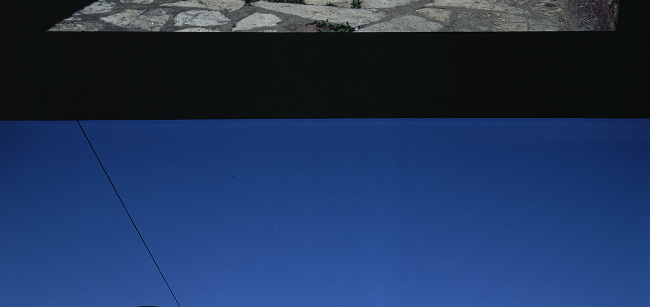

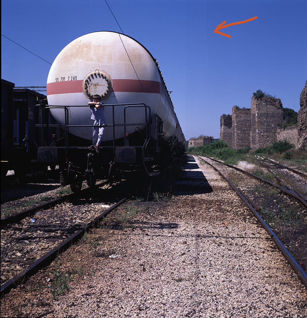

Hey all, i'm having issues with E6 now. What can cause this pattern on slides. It's not scanning artefact as i can see it with loupe when slide is on light table. I use Jobo CPE2 without lift and i use E6 chems one shot only. My CPE2 is modified with super tight temperature control unit and it has a pump to circulate water. I've changed drums, lids, cores. Only thing that might be a culprit is a uneven rotation CCW is little bit slower than CW, and there is a slight wiggle of motor shaft so when drum spins it moves 5mm in both axis.
I've also attached one of older C41 scans, on badly exposed images this line could be seen, but what puzzles me is that this line is visible between frames as i said in previous thread. From now on I'm using a acetic acid stop bath and this problem is almost gone, almost because in really underexposed negatives and with some scanner tweaks you can find this artefact but otherwise it is not visible

Faults that are seen in direct light go in prints or scans.
Faults that are seen only in reflected light, usually not go in prints or scans.
What can I find the images presented:
Appear different problems.
Velvia 50 in the picture, I see two perfectly straight stripes that separate different densities.
Here you can think is defects of film.
Ektar in the picture, I see a line with a small curvature, which is accompanied by parallel rubbing weaker.
Fault handling (so you can see and between frames).

Thanks for the answer. and PDF file :D. One line is completely straight and that might be a film defect or something else, but the other one is not, so i guess processing defect.
I guess this could be it?
Curtains - Faint vertical streaks of non-uniform density - Improper developer turbulation. - Follow specifications for turbulation coverage, pressure, and frequency.

I assume that the malfunctions that occur are straight and continue generally is the problems with film or processing machine.
Faults less straight, curved, irregular are manual handling.

I don't think that defects in film caused this, much more likely are the chemicals. Specifically the volume of the chemicals.
This could be even as simple as how fast chemicals were poured in. If any of the chemicals were poured into slowly it could cause uneven development. If the levels were not high enough to cover the phone properly it could end in uneven development.

Since you are using a CPE without the lift, I presume you are pouring chemical in the tank while upright, capping it, then placing it on the magnet. If so maybe some of the film is in contact with developer longer than others. What you may want too try is to get the tank spinning on the Jobo with the cover off and pour the chemical in using a long flexible funnel. I use my CPE with and without the lift. When doing BW I often go without, but always use it with color due to the short times involved.

Misko 78, can you give us details about the fault on Velvia?
Failure is the only, or there are others in the same film?
The more details there will be a greater chance to find an explanation of the fault.
I personally have never seen a malfunction chemical (process) nature so right.

I can see this fault on some of my films not all, fault is in direction of rotation running on whole lenght of film but can be seen only on blue skies and really light areas. If there was less chemicals then it was supposed to be part of film would not be developed.
Yes, jerrybro my method is exactly as you've described, unfortunately I don't have lift and i need 8 seconds to pour in chemicals and attach tank back to drum and start rotating. High speed of my Jobo CPE2 is, what i have measured, 52 RPM, low speed is 25 RPM. I always use high speed because motor will stall on low speed sometimes.

I was plagued by vertical streaks processing E6 and C41 using a CPE2 without lift. I also tried stop bath and pre soaking but what I think has finally fixed it came from an explanation I discovered on another forum which fitted my experience. I couldn't work out how the streaks seemed to come from the edge of the film by the top of the tank. The explanation is that if you try to fill the tank too fast chemicals spill over the edge at the top of the filler well (where the chemicals drain out of when you turn the tank on its side) and you get a streak down the film. This made sense and I've only tried a few sheet films recently being careful not to fill too fast allowing all the chemical to flow down the centre hole and have not had the problem. I was trying to fill the tank as fast as possible for even timing but was in fact introducing a worse problem. Try it, I'm sure you will find an improvement.

Thanks Richard, i'm certainly going to try that. I'm really pouring it in fast. 7-8 seconds from start to getting a tank on a magnet. I have streaks running on whole length of a film.

I repeat, malfunctions that may occur due to faulty agitation generates slightly irregular photographic effects: trace, scum ....
In any case not perfectly straight line as you.
Your fault does not fit into any of the defaults presented in book.

Richard's suggestion sounds very interesting, and I would like to add a few observations to his:
  1. When you dodge and burn during enlargement of photographic paper, you can change exposure between two areas by quite a lot before it becomes apparent. If you put a coin on the photographic paper for just a fraction of the time you dodged in the previous situation, you will see clear artifacts. Therefore it doesn't matter that much, how quickly you fill your film tank, but liquid level must steadily progress from bottom to top, without any time periods where liquid level stays constant and below upper film edge.
  2. When you pour liquid into Jobo tanks slowly, liquid runs down the funnel, through the center tube into the tank, while air escapes through the side gaps of the funnel inside the tank lid. If you pour too fast, liquid blocks these side gaps, air can no longer escape easily, and as a result the liquid you pour in backs up. This could well lead to short periods of time, where liquid level inside the tank stays constant, leading to the artifacts you see.
It would be well worth trying to practice filling that tank quickly but continuously. If this doesn't work well, you could try opening the tank in complete darkness, pour in the E6 FD, then close the tank lid and progress as you did before. Note, that E6 FD step is the only time critical step, so there is no need to do this with the other process bathes.
