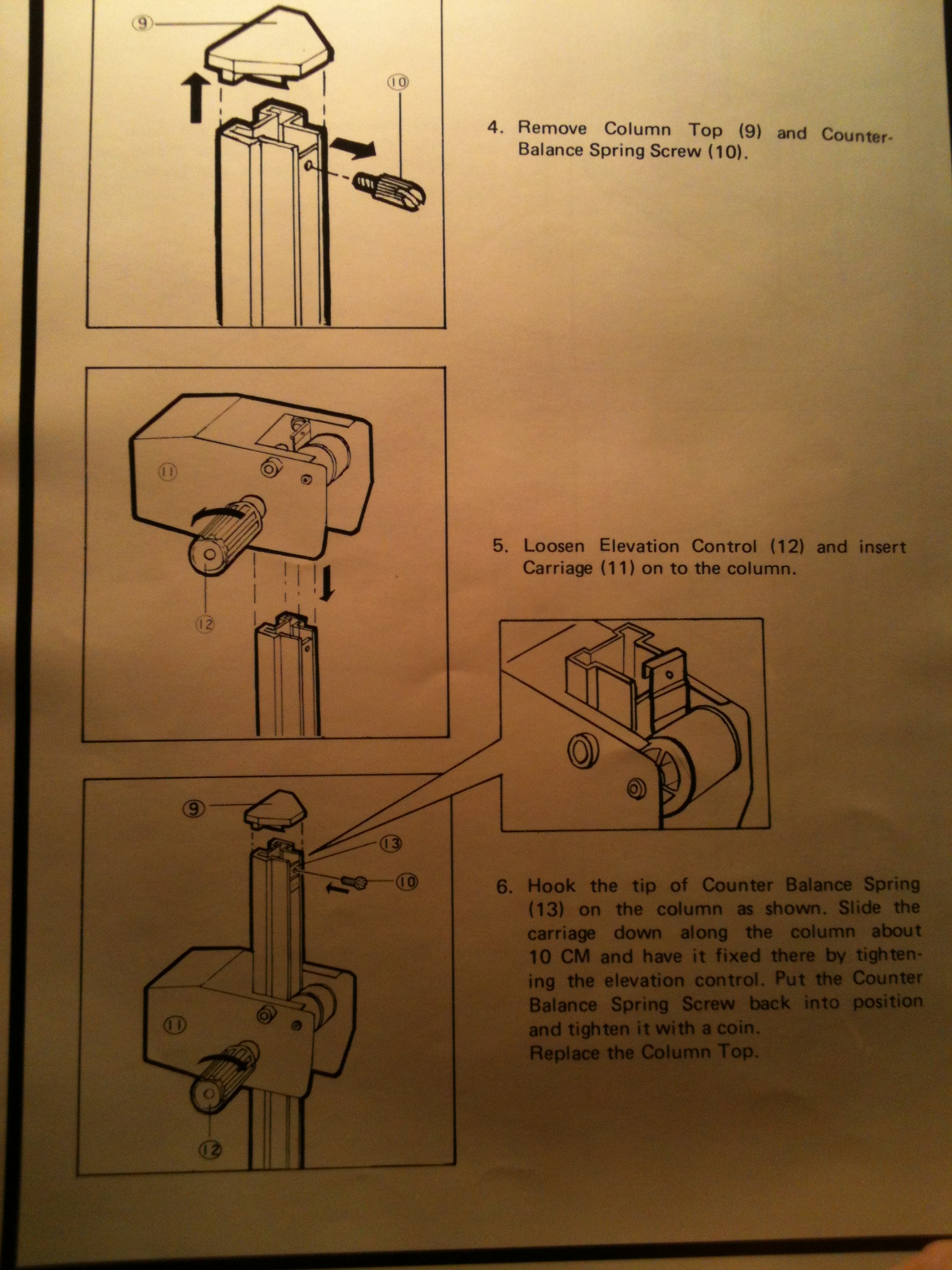

1. I'm excited about the enlarger, I've set up it (it came in pieces) and the only problem seems to be the movement of the enlarger head. When I "unlock" it to change the height, I have to hold onto the head to make sure it doesn't slide completely down the column. This is contrary to every other experience I've had with other enlargers -- perhaps I set it up incorrectly? Or is this normal for this enlarger? Unfortunately I only have the Japanese manual and the pictures only tell so much. I am willing to buy the manual in English, but if anyone has it (scanned, pdf, whatever) and is willing to share, I'd really appreciate it.

Congratulations on setting up your darkroom, imagine you must be anxious to begin printing. Can't help with the enlarger other than it sounds like the spring in the column is not attached to the head assembly. Probably coiled up tight at the base of the column or the top.

Yippee!! I am happy for you. You might check the top of the enlarger column for some sort of ballast, or maybe the rear of the head. It may be a coiled flat strip of metal resembling a coiled spring, or cable(s) that connect to a torsion spring. The enlarger head shouldn't want to drop on its own when the lock is loosened.

When tension thingy might not be attached at the rear top of the column, mine wasn't. I have a C7700 Pro but i think all the LPL'S are the same...

I think my 4x5 LPL is counterbalanced with a spring arrangement, and your 7700 is probably similar. I've never had a reason to explore its details though.

That page looks the same as mine but I'll double check in the morning. The explanations are a lot clearer at the bottom though. Thanks!

That reproduction is a bit poor. To aid ath's comment, the spring is the silver metal band coiled on a spool, attached to enlarger head assembly just behind the column.

To everyone else -- head/column/spring issue fixed. Don't know how I missed hooking on the spring, but I did and (for) now all is well.
