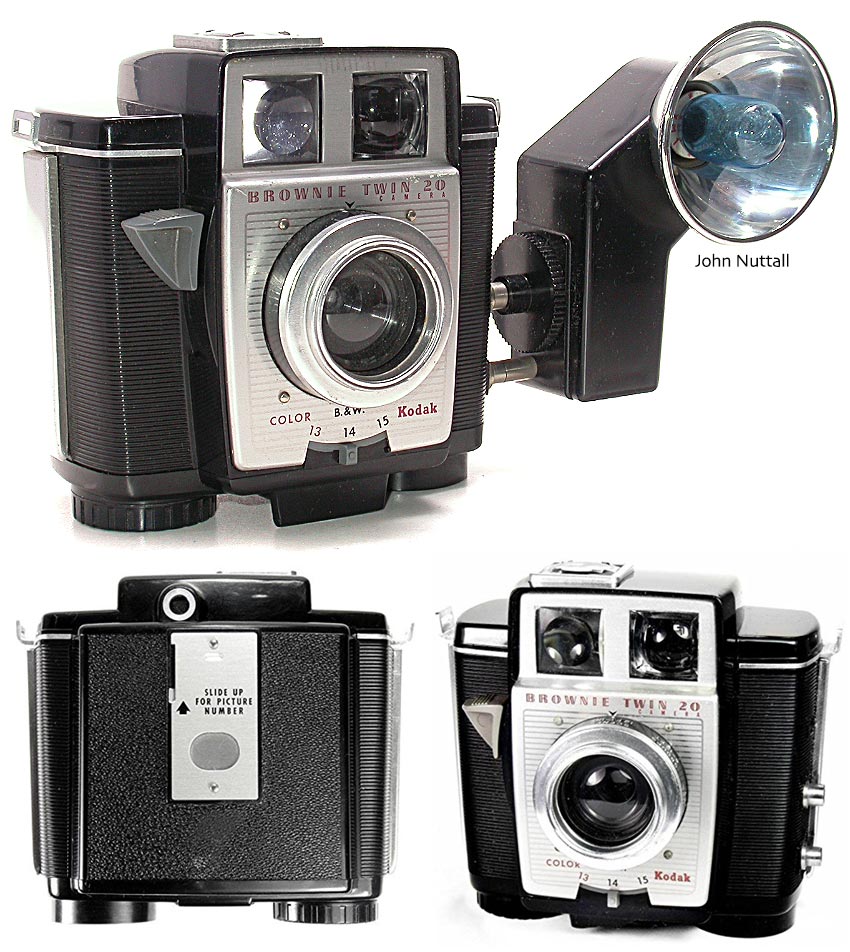

Kodak Brownie Twin 20:
https://www.brownie-camera.com/48.shtml

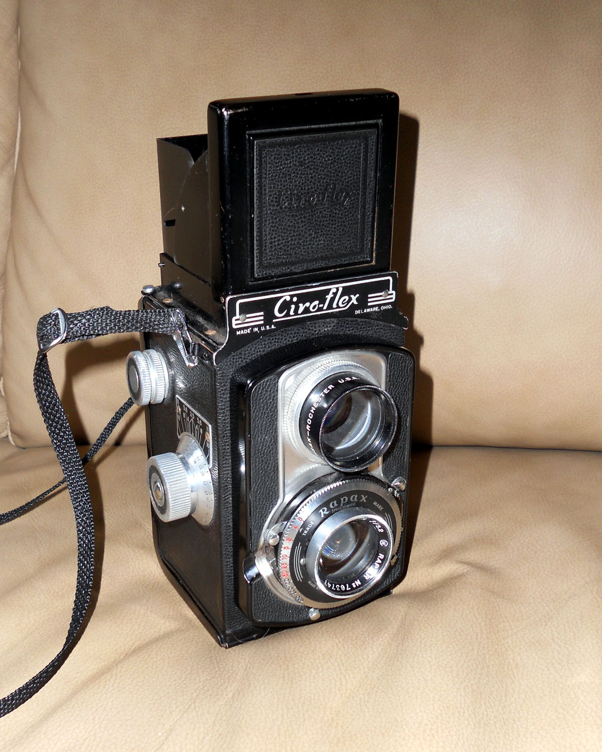

There were a few 120 TLRs build in the 50s that could easily have been usable in the 60s. Here's one that I own.
