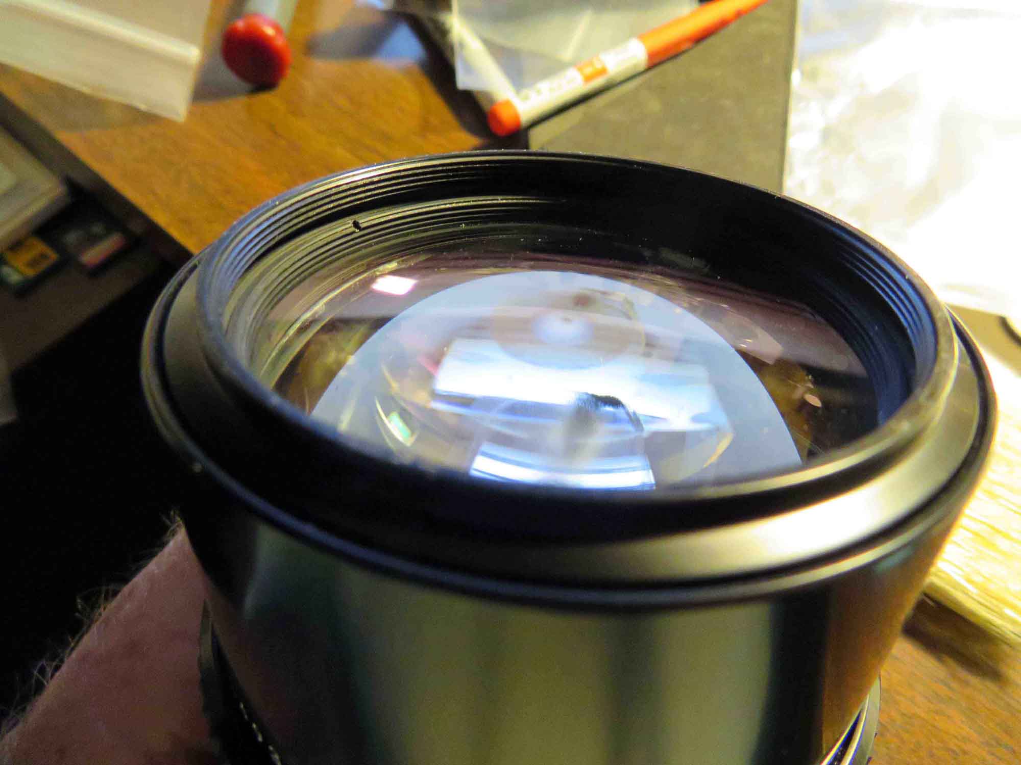

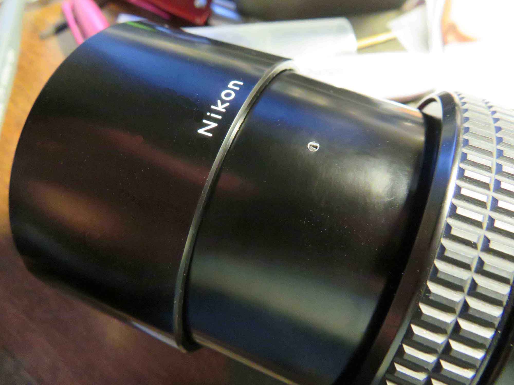

I have an AF-Nikkor ED-IF 200mm f/3.5 lens used with my F3AF body. The front element has rather large scratch on it that I have always wanted to address but to no avail as I could not find a donor lens. I recently acquired one that has a busted aperture and the AF motor is shot, so it is a perfect candidate and has a pristine front element. However, I cannot seem to get the thing off the lens. There is a ring holding the glass in place which I can turn with my spanner wrench, but it only comes out a few mm and butts into the filter threads on the front of the lens. I pulled out the built-in hood and found a set screw in the side. I figured you must unscrew this and the entire front body can be removed. Once out the front glass can be removed from the rear of this assembly. But . . . . the tube will not unscrew. I have even tried a lens wrench and it won't budge. Have tried a couple of solvents to loosen the joint without success. There is absolutely NO information on the web about this lens so I am a bit perplexed. I have contacted most of the repair facilities around the country that work on Nikon F3s and none of them have ever worked on this lens. If anyone out there has any experience with this equipment I would really like to hear from you.

I'm not familiar with this lens. But a general tip from similar lenses. Raise the hood and turn it around until the hole on the hood (if there is one) lines up with the set screw under. Loosen it and you should be able to unscrew the filter thread ring with rubber glove or rubber tool. That should give you access to the lens element.
