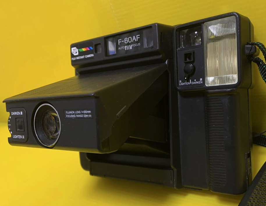

hello,
I did some converting on a fuji Fotorama F60 AF
to make it work for large format cassettes. unfortunately
the standaard 4x5" doublecassettes don't fit in... but it seams to work with more special 10x15 filmcassetteslets see
if this snoopy is doing well

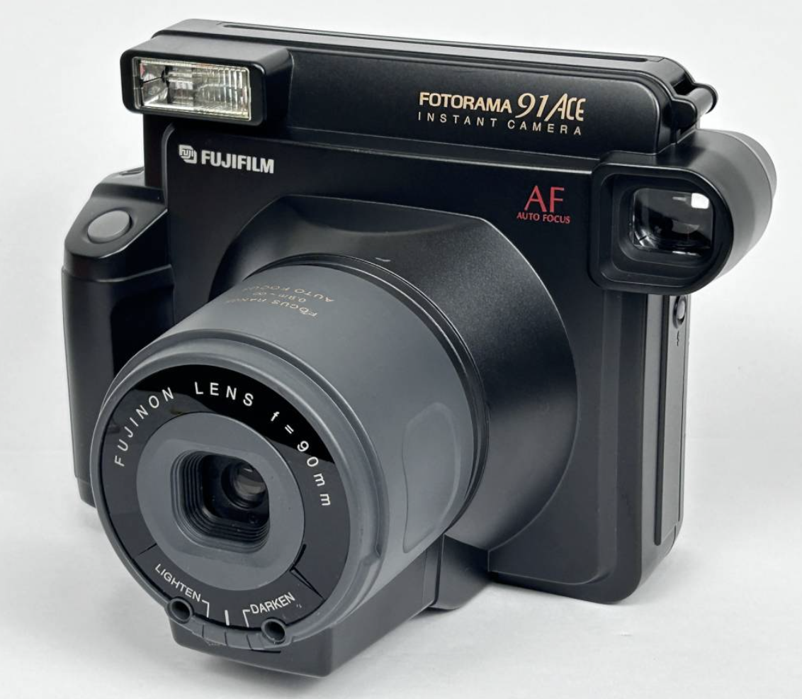

This?
I can't tell anything about it due to the webpage showing this image is in Japanese. What film format is it supposed to take?
MattKing
Apr 24, 2005
55,508
Delta, BC Canada
I would guess some version of Fuji instant film.

hey,
it is a foldable '80s AF automatic camera
it is made for (discontinued) FI 10 film, slightly bigger than Fuji Instax wide.
it is 160 asa, and the cassettes are 10.5 wide, so it is a pity if they were a little wider I could use regular 4x5" film backs,
now I'm using the older singel metal 10x15 back, (these are 10cm wide.
I'm ordering an other camera in Japan now, the 800 AF for modification, it is the same, but for 800 iso (I'll have to cover the light meter with a 2 ND filter.) but it has a better AF.. lets see where we get.
it is a fuji Fotorama F60 AF.. I'll upload a foto soon :smile:
