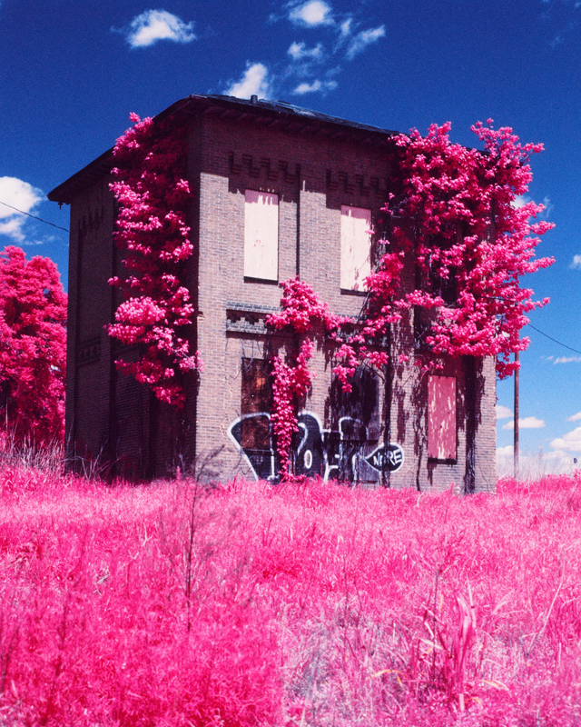

I've found that an orange 16 filter seems to work the best, at least for me. I rate it at EI 500, as I've found this keeps the highlights and bright areas from blowing-out too much. You'll definitely want to experiment some, though.

Here's one I took at EI 500 with an orange filter.

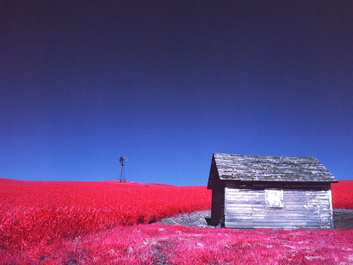

I have only used a yellow filter but I was happy with the results. I enjoyed this film but the cost prohibited me from doing a lot of experimenting with it so I just went with the Kodak recommendation of a yellow filter. More photos here: https://www.flickr.com/search/?user_id=60348236@N07&sort=date-taken-desc&text=Aerochrome&view_all=1
Palouse Shack and Windmill by Bryan Chernick, on Flickr
Thanks for sharing the results guys. It seems the orange filter gave a more pinkish vibe than the yellow filter and both look absolutely stunning!
