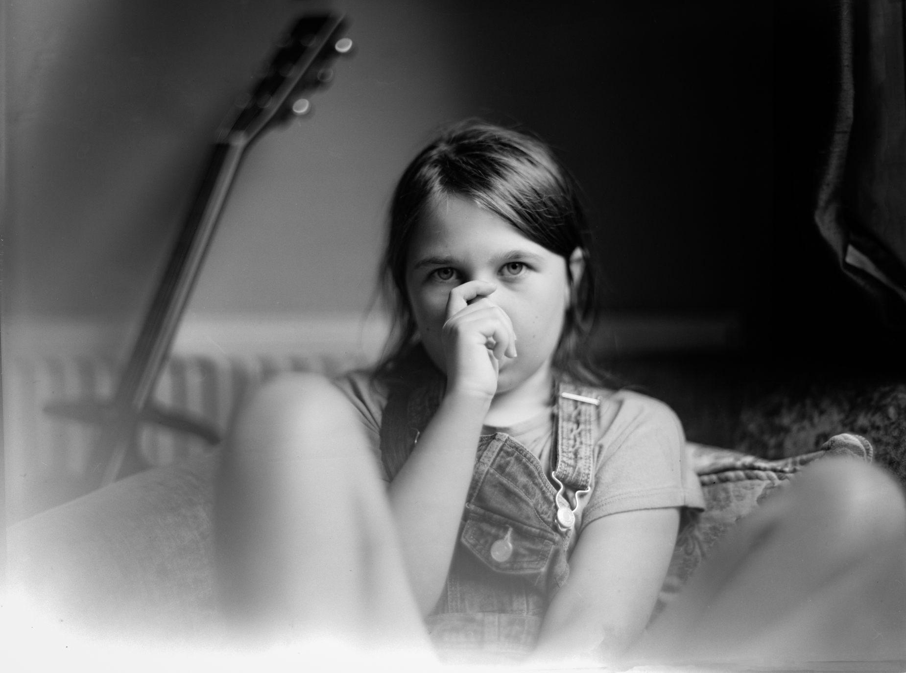

I think the negative shows the focal point behind where I focused (see pic)
If this my my ground glass is too far back from the lens, how do I correct this? I did take it out to clean it, so perhaps this affected it.

If all your shots show the same 5" (?) at the same shooting distance then I'd wager the problem is ground glass placement. If the point of sharp focus relative to where you focused varies from shot to shot then it could be movement. Inserting the film holder into a well screwed down Speed shouldn't move anything much at all.

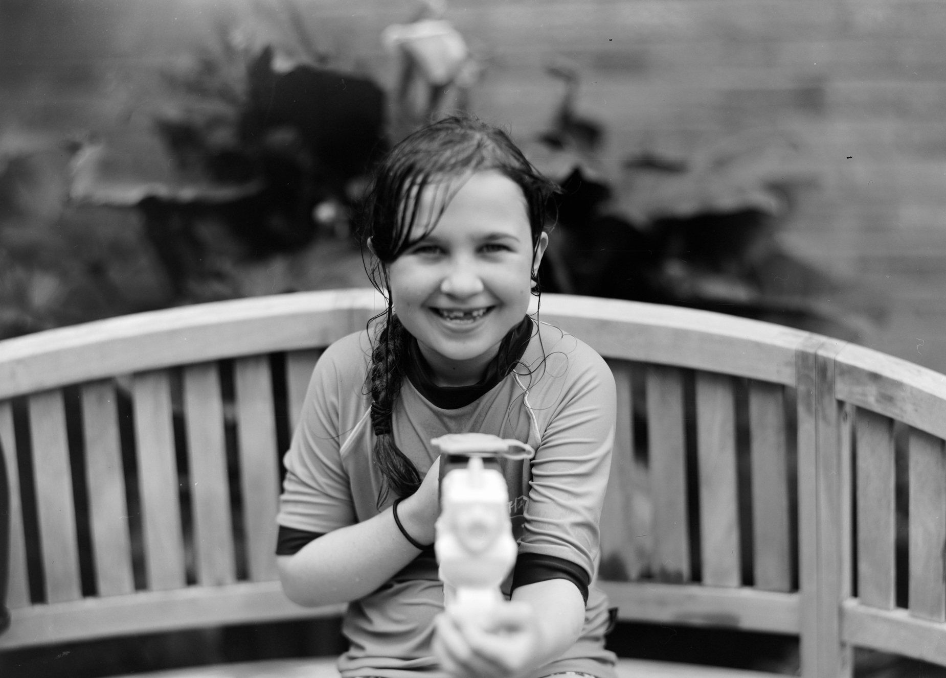

The picture above was taken at f2.5
One last question, please: Nicholas Linden said you can remove the fresnel to the outside of the glass. Does this mean on top of the GG? And if so, won't that cause the same mis-focussing problem?

Yes you can. As long as it doesnt disturb the position of the GG. So just place on top on the side closest to your eye. If you need to check you can focus with a loupe without the fresnal and recheck with the fresnal in placwe.
