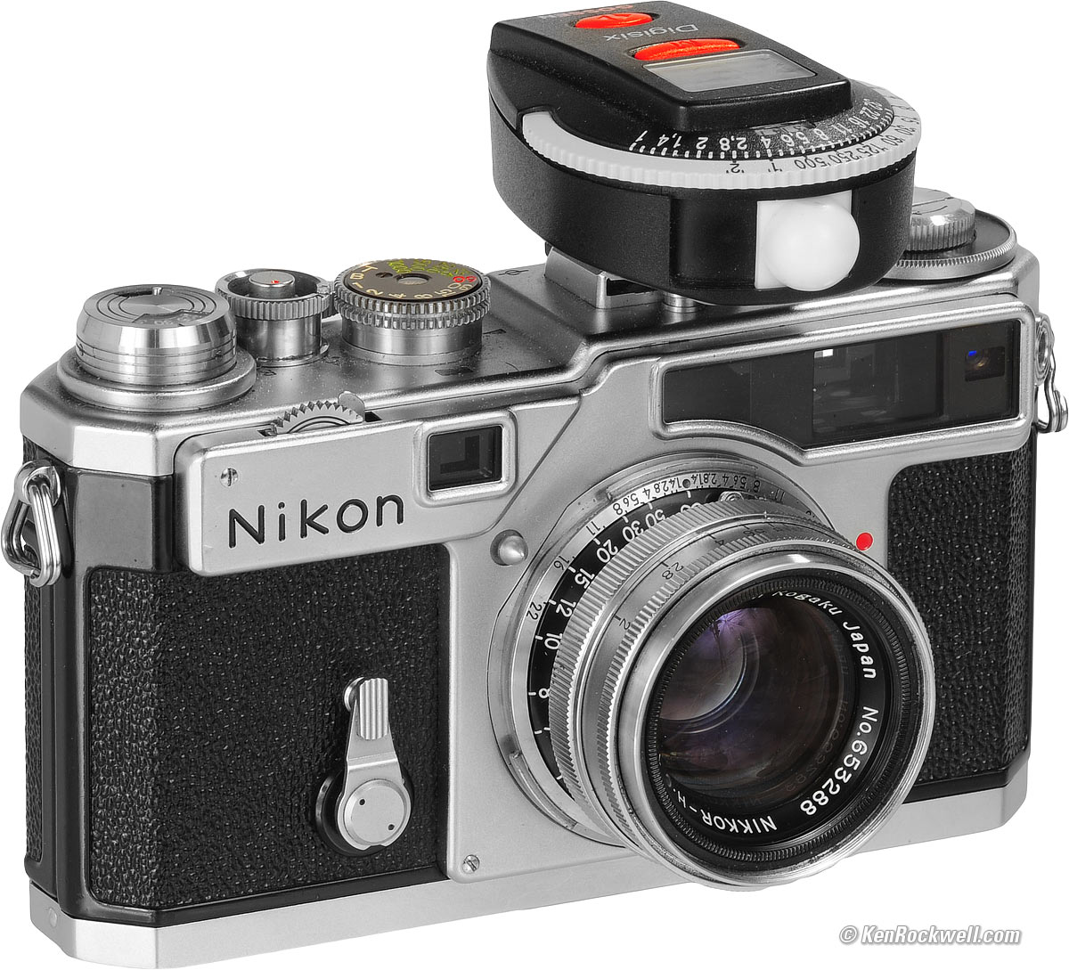

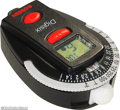

Gossen DigiSix:
http://www.kenrockwell.com/tech/gossen/digisix/index.htm

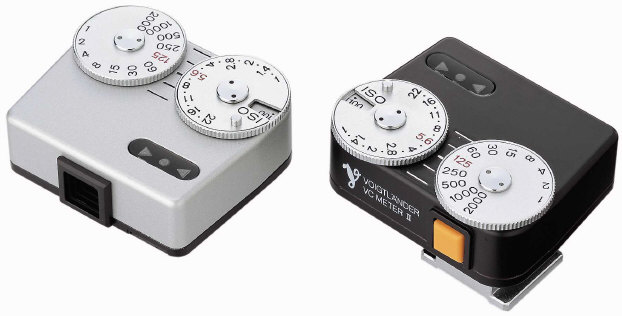

Voigtlander VC Meter II:
http://www.cameraquest.com/voivcmet2.htm

I was looking into this recently and it seemed the the Gossen and Sekonic mentioned were the best choice. The Voigtlander was (IIRC) significantly more expensive.

At the risk of being picky, it is probably best not to use the Digisix in the way pictured on that Nikon rangefinder - as the integrating dome is in the incident metering position!
Mat,
Ken R was probably taking a picture of THAT camera, not using that camera to take a picture. As a super professional photographer, KR surely knows how to use his light meter! :D
By the way, I noticed that, too. :tongue:
