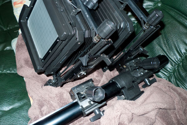

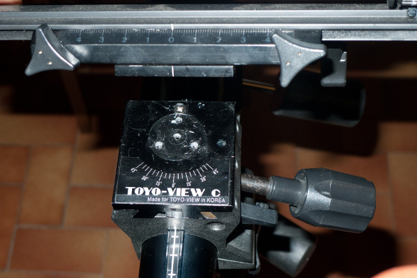

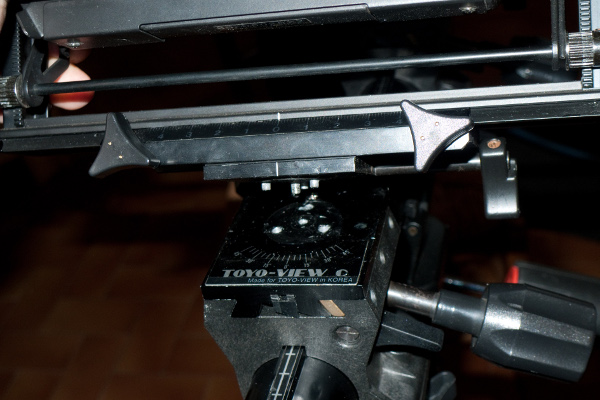

Hi everyone,
I have a Toyo 45C 4x5 monorail view camera that has been damaged during international shipping. The rear standard frame got pulled so strongly from the block while hanging from the rail in its case during shipping that it sheared off the screws which tie it securely to the block. The scews seem fine but the holes seems useless now as one can pull the rear standard up from its block easily.
I'm looking for advices on the best way to fix this. I'm thinking about gluing the screws in the block holes. Anyone who has had this problem before? What type of glue would be wise?
Thanks for your help.

Other than replacing screws and that pivoting part the screws fit in, I would drill/cut a one size larger thread, drill out the holes at the standard and fix everything with larger screws.
Mike Wilde
Aug 10, 2006
2,903
Misissauaga
Mix of hardwood coarse sawdust and white PVA glue. Force into holes with a toothpick.
The sawdust allows the filler to flex somewhat when the screw is driven in after the glue has set.

Your best bet is to replace the broken parts. Second best, to replace the screws with a larger size. Glue is probably the method least likely to work.
Deleted member 88956
The glue is NOT worth trying, but it is your choice to do it anyway. I say this only because the bond has little space to make a permanent fix and with such a small area of contact, it is not going to be a sure fix. To extend that area, you would have to rough up the bases that are in contact and it would have to be done quite well, so you could sleep better, BUT we now get into bastardizing the camera (perhaps not everyone would agree). Every time you use it, you'll be thinking about that part, and what are you going to do when it fails at the least opportune time?
Screw replacement is a rather easy fix (and a good one, but its cost depends on whether you could do it yourself or a machinist would have to do it for you). If the latter, then you may still be far below the cost of the whole block, provided you find a local good machinist and not send it to the few, always mentioned here, camera repair shops.
Another option is to check ebay and similar as often you will see the rear standard on sale for not much money.
