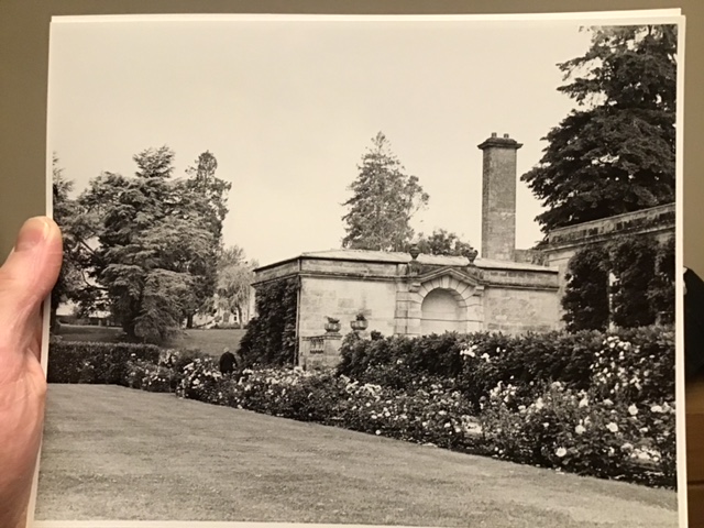

Last night I was printing something like my 10th print ever so very new to this but ended up having to expose the paper for something near 2 minutes towards the end of the printing period (did it for a couple of hours) whereas usually in doing test prints with 5 second intervals I usually find the right range and have made prints I really like, usually at f/8 for say 15-25 seconds, which seems like a regular time and procedure.
I’m Using Durst301 35mm enlarger, Ilford RC Multigrade paper and developer.
So far all the prints with regular exposure times were from Ilford film, say SFX200 or HP5. The prints that needed extended exposure were both Fomapan 400. I shot the Foma on an old Kodak Retina.
The last negative needed a really long exposure time and I messed a few prints up not believing it could be that long.
I may have made a mistake by leaving the enlarger on for the whole time I was printing - an hour. Perhaps the bulb is burning out? (Don’t think that’s right as I nearly change lightbulbs for a living) but really perplexed! I think I should read up on negative density again, I have heard about images that work well with printing... anyway. Excuse the long post, I looked for a similar post but didn’t see one.
Any suggestions?
Thanks for reading!

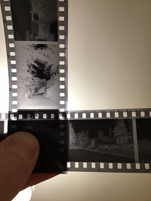

This could be a slow shutter on the Retina.
Your experience would make perfect sense if the Foma negatives look as dense as a pair of sunglasses.

Firstly, it’s Foma 100 not 400, my mistake, and I realised I had developed it in Caffenol as a trial. And rather badly if I compare it to the SFX developed with DDX. I didn’t clear the negative if that’s the right term, I mean to say the edges are underdeveloped and foggy.
One thing I didn’t say is that when I scanned these 6 months ago they came out “fine” (because the red banner said don’t mention digital!) but there must be some automatic exposure compensation on the scanner as I never noticed how under developed the negative is (so - sorry if I’ve wasted your time but the comment about the sunglasses is about right... er embarrassing).
If I can attach a picture I will, might make you chuckle at least. I will say the other frame from the same roll printed okay at 1 minute exposure (!) so inconsistencies all round...
To finish, it was fresh developer, and the lamp probably wasn’t dimmer although last night I was sure it was something wrong with the machine not me!
Possibly slow shutter on the Retina, but with no built in light meter, more likely I chose a slow shutter.
I had so carefully checked the aperture and actually stepped back for the three minutes, murmuring to myself.
So thank you all again, I suppose this is the lesson I really did need for shooting, developing and printing. I’ll try opening up 1 stop and still expose for two minutes and see what I get.
So would that be termed a very dense negative (grossly dense perhaps)?

The dense negative looks maybe a stop overexposed. More importantly, it looks like it has an high overall bass fog - also somewhat mottled-looking. Maybe it would benefit from refixing. It seems to enlarge well enough, though.
You will have dense negatives. And you will have negatives with areas of density that may require burning of more than 30 seconds. It's all part of life's rich pageant.
