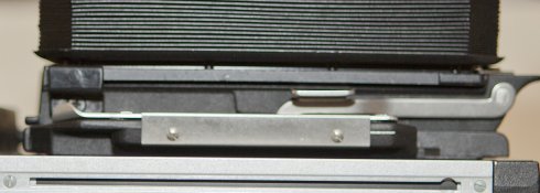

I worked for Sinar presenting seminars back in the '70-'80's so I am quite familiar with the F+. I own one.
The camera can be folded quite easily and carried in a backpack.
I hope the pictures help me to describe the procedure:
1. Attach the bellows to the back of the ground glass back like you would if you were using it as a viewing hood
2. Move the standards to the ends of the 12" rail
3. Loosen the rise/fall knobs and tilt knobs on both standards
4. Fold the rear standard down against the rail with the ground glass facing upward and the bellows attached
5. Then fold the front standard down to rest on top of the bellows
6. Tighten the rise/fall knobs and tilt knobs
7. Leave the tripod mount on the tripod
8. Depending on your lens you can often leave the lens attached to the inside of the front standard which will offer it some protection
Hope that helps. If I can answer any other questions about Sinar I will try so please send me an email: Rick@rickrosen.com
I also teach large format workshops in CA and it does my heart good to see there is still interest!
