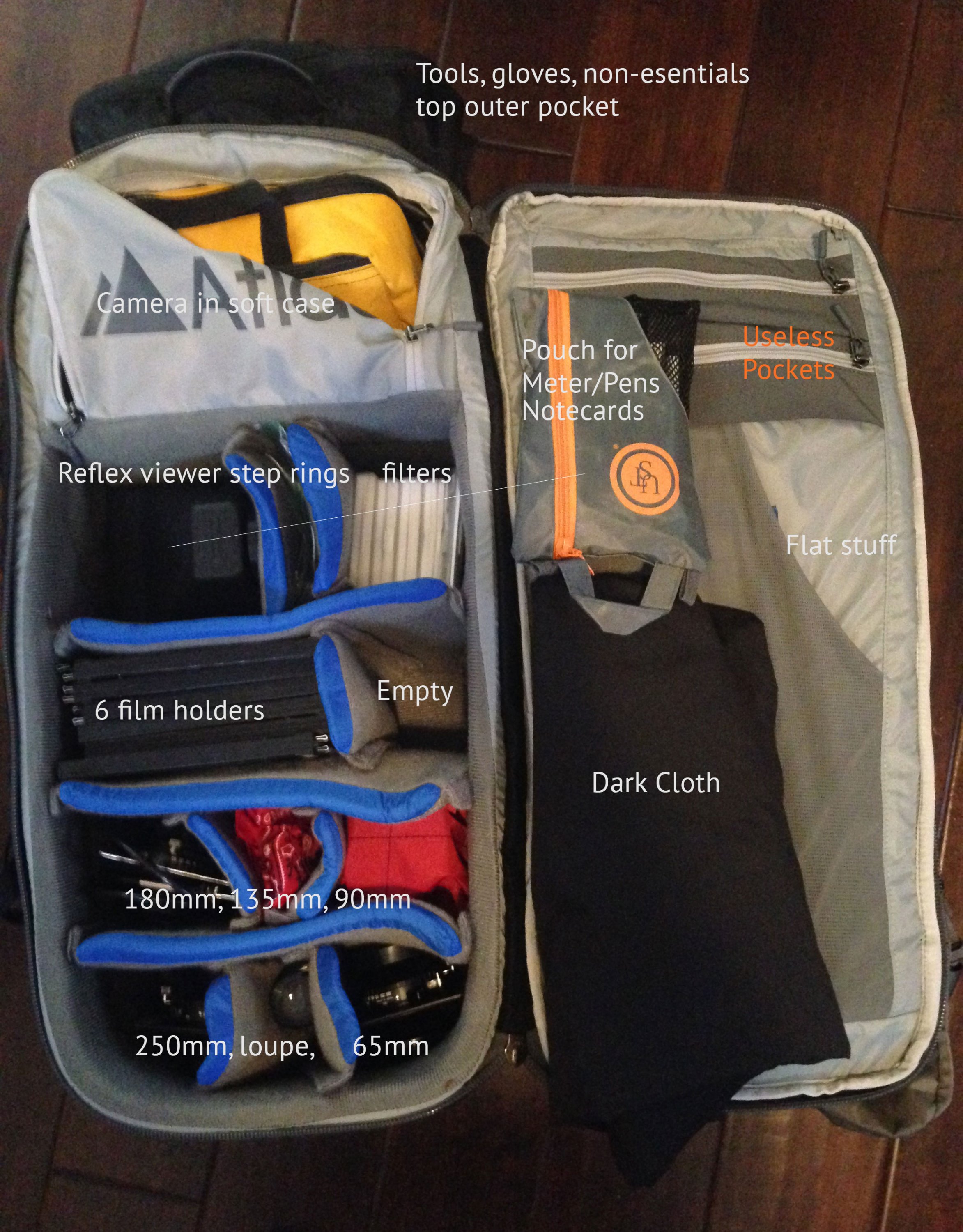

Atlas backpack are awesome, but will set you back some coin. The Athlete is smaller for a camera , 2-3 lenses, and 5-6 holders. It is comfortable to wear and expandable for an overnight campout. The Adventure pack is huge and will hold just about anything you want to bring. (see image of mine) I like these because they open from the back and are easy to work out of without having to unpack a bunch of ICUs.
If you can carry your tripod with the camera on it You might look for a camera pack that splits in the middle like the tenba cooper dslr pack.

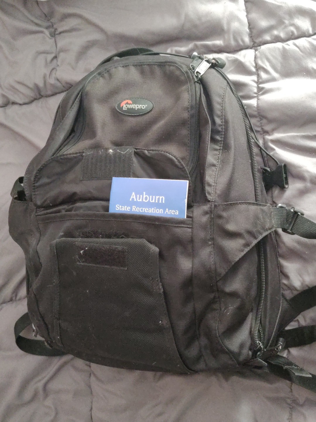

I have a Lowepro AW and it works great. It is the size of a daypack but enough room for camera, lenses and film holders.
I have a Polaroid ysarex for a normal lens. I can trim down with a g claron for a long lens. But the smaller wide angle lenses are just not as good.

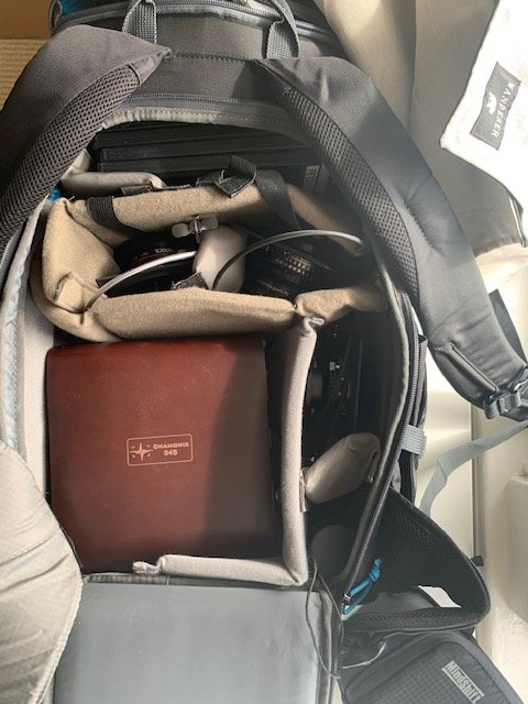

Here's what I've worked out without buying anything... using this "small" pack I've got:
So included here is the Chamonix wrapped in a leather protector, 3 small lenses on lens boards - just in their pockets and with their cable releases, 6 film holders, and a Toyo Loupe. I've got room for a standard size Wanderer dark and a meter. I'm keeping a lens wrench in a side pocket and have a Lee square filter kit (assembled slowly over the years) for B&W contrast filters in a Mindshift pack that attaches to the lower outside of the pack. In the lower left corner is a Tenba lens wrap that nicely covers the lens/camera area to add some more padding "just in case", and to help keep things from falling out just 'cause the pack's back zipper is open and the flap back. Lens space is a little tight, compared with some of the pictures of packs sent me, but it's a place to start.
Separate Carry: 1) Tripod. Upgraded to a nice lightweight years ago, but finally putting some mileage on it... 'cause with 4X5 you it's not an option like it is with virtually every other camera (35, MF and digital). Recently acquired a used Manfrotto geared head from KEH to replace the RRS ball head I was using.... 'cause that RRS thing.... had terrible lock downs which were too small for even my small fingers and always seemed to be located in the wrong spot at the wrong time. We'll see how it works later today!!! Got the idea after lots of thumb exercises and Kenneth Lee's tech comments ( http://www.kennethleegallery.com/html/tech/index.php )... which BTW, he has a fair amount of useful info. The Mindshift case (for now) is going to be attached to a loop on the outside of the pack, but also think about putting it on my belt or somewhere. Belt's probably not going to work. Not carried is a Macro lens and long-ish telephoto (400mm NIkkor T) which will probably ride (or not) in the car.
Weight: Without the Tripod and Head is inside 20 pounds. And I guess I'm not going to be thirsty or anything... 'cause there's no water bottle or any of those practical things. I am liking the shots I've seen of the Lowepro AW as looking like there's room for padding and spacing the lenses more comfortably (for lens care). But that depends on what's up with the used market I thiink.
"nuff said and 'nuff equipping for the meantime anyway. Thanks for all your insight and recommedations.
