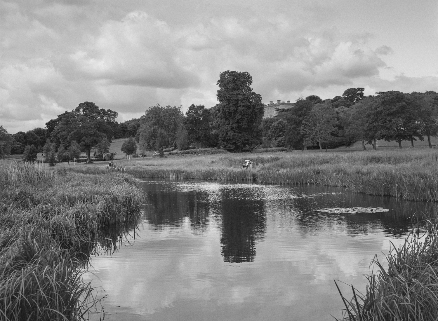

Since moving to film last year, I have always been disappointed in how the sky is rendered.
I photographed this with Kodak TRI-X 400 using a Pentax 645N and a 75mm lens.
It was developed in Kodak HC110 diluted at 1:63 for 9 minutes at 20°C
Does the rendition of the sky look like you would expect from film ?

It does if you didn't use any filters.

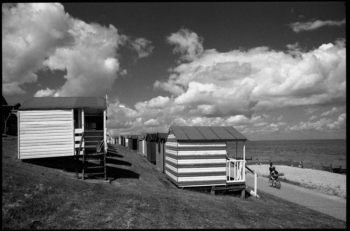

I am also in the UK. My experience with filters is that they don't make any difference to clouds if the sky is overcast and conditions are dull. If it is cloudy but bright then a yellow filter helps to define the clouds better. Despite our weather, we do quite often have broken cloud with patches of blue! I have uploaded lots of pictures taken in the UK to the gallery (and some recent cloudy Austrian photos). I always have a yellow filter on my camera lens as a default (when shooting B&W obviously). Orange and red darken the skies even more. You need to add exposure to allow for the light reduction through the filter if your camera does not have TTL metering. Even so, with a deep red the TTL metering can get confused.
Here is what a yellow filter can do in Portsmouth in April. The sun was trying to shine through those storm clouds so conditions were fairly bright.

Thanks everyone for the replies, from what people have said, it appears that the rendition looks ok so thats put my mind at rest.

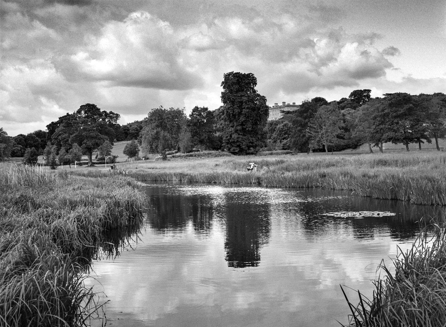

You have a grey subject taken on a overcast day that lacks visual contrast. No filter is going to help you in this situation.
Ideally, you would have increased the development time (assuming you did not have other images on the roll taken in bright contrasty days) to compensate. However, in these days of multigrade paper, all you need to do is increase the contrast and give additional exposure to the sky and it's reflection in the water.

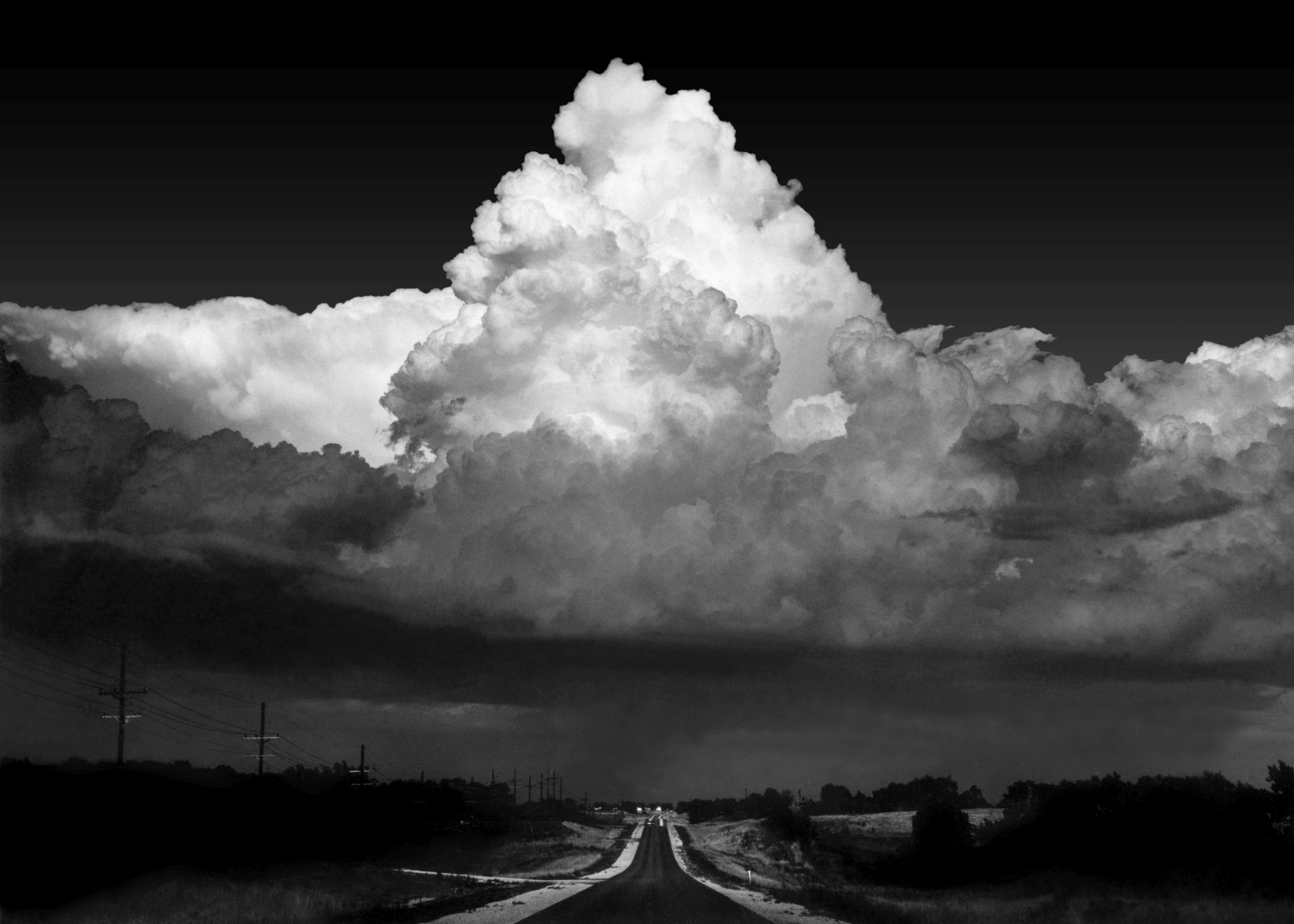

If the foreground can be sacrificed to emphasize the clouds, a high contrast film such as the greatly missed Kodak Tech Pan exposed through a red filter at about ISO 400 and developed in Dektol yielded this.
Advice relating to after the point of taking the image doesn't help the OP. That is why I have demonstrated what could easily be done with such an image.
