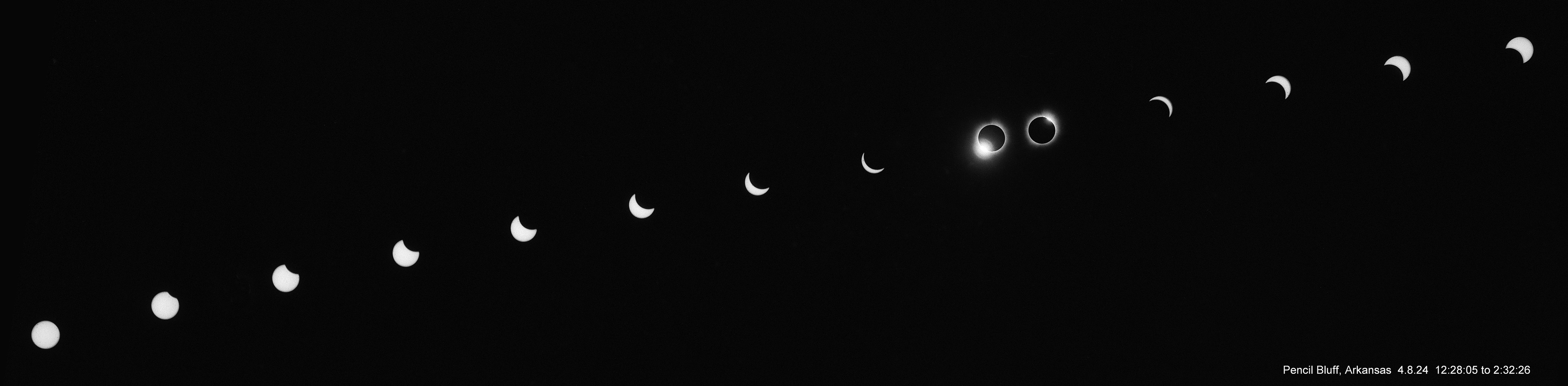

I created a multiple-exposure image of the April total eclipse with my 4x5, scanned it and had a print shop make a print -- 60" x 18". Now I want to mount it but am not at all sure about the best strategy. I would like to mount it on rigid board rather than put it in a frame. It occurred to me that 1/2" insulation board might be a good material -- it's lightweight, easy to cut, and appears to be dimensionally stable. So that's my first question -- is that a good choice? Next, adhesive. I doubt that dry mounting via heat is practical. I have heard a person can use a household iron set to the right temperature but I question my ability to do this without ruining the print. Is spray-on adhesive viable? And process. I initially thought I should cut the board to the exact size, but the chance to get the print crooked seems pretty high. Is it workable to adhere the print to an oversize board, and then cut it to size with the print in place? Without damaging the print? Any advice would be appreciated. Thanks.

Thanks for all this input. The image was created by ink jet on semi-gloss photo paper. I called the print shop back and discovered they could have printed it directly onto 3/16 foam core for the same price. It never occurred to me to ask. They did say that all that black (see attached) may not reproduce as well on the foam core option as it did on the photo paper. On the other hand, they did say that if I wasn't satisfied with the print quality, there would be no charge. They were very helpful, and will lend me rollers to assist in affixing the print if I decide to glue the print onto the insulation board (they thought that would be a good mounting base). So I'm going to shop for some 3M adhesive, stick the print onto the board, then trim it. If that is a disaster, I will take them up on printing it directly onto foam core and see if Plan B works. Thanks for your willingness to share your experience.

Two things. I find it amazing that they are willing to mount it for FREE. I also don't understand how mounting it on foam core would alter the print in any way. How would white museum board be any different?
OK, make that three things -- one problem you can run into mounting large prints is the foam core (or whatever) bending -- when the adhesive dries or cools.
koraks
Nov 29, 2018
22,726
Europe
Two things
I think you may have misunderstood both:
printed it directly onto 3/16 foam core [...] may not reproduce as well on the foam core option as it did on the photo paper.
Yes, certainly. And getting a crease-free bond in the first place will be challenging across the length of this print. I'd practice on a couple of smaller prints, first.
