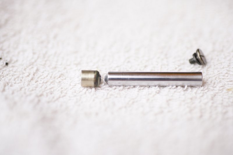

I'm in the process of going over my Mamiya Super 23 with a CLA when I noticed I have a broken part that needs replacing. I haven't even used the camera and don't know how or when this happened. It wasn't like this when I received it a while back, so it had to have happened on my watch. Probably when I transported it back and forth from my cottage to home. Oh well, shit happens, I guess.

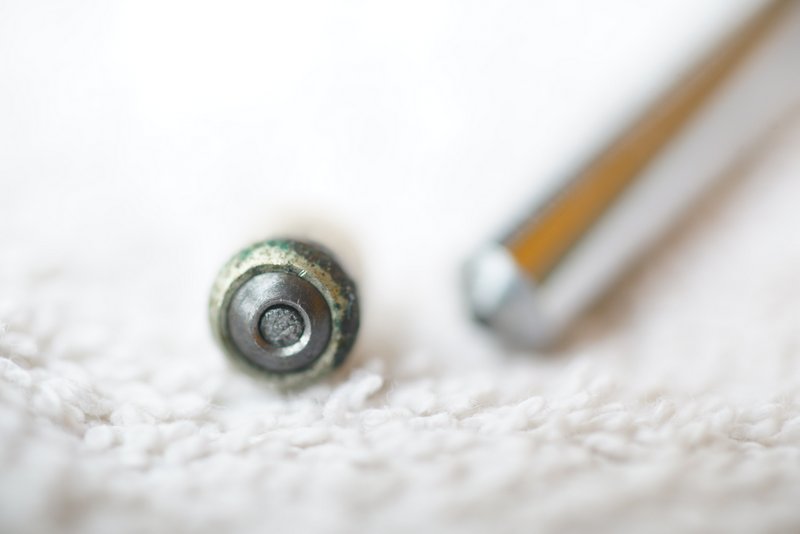

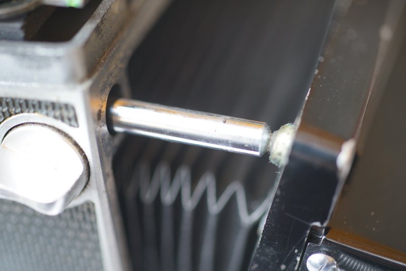

It's one of the four rods for the back bellows. The rod has a small ball swivel on the end, and it seems the part that goes into the swivel ball is snapped off. The part number is SN 105K2 "Rod, bellows movement assembly" Common parts number is cSN 1221K2. Does anyone know where to possibly find this part? I contacted Bill Rogers, but no luck. Might have to try to find a parts camera? Here are some pictures of the part itself.

I couldn't find anyplace to buy the part I need, so I just bought a nice, black Super 23 from Japan for $69.00, shipping included. Can't beat that with a stick, since the part I needed would probably cost near that itself.

Yes, that's what I'll do. The one I just bought actually looks nicer than the one I have now. Also, you can operate the back just fine with three pivot rods. Of course, four makes it a little "beefer", but three works.

That makes a lot of sense. The back movements are only useful if you have the special ground glass accessory. Even if you have it, it still means you have to switch that out again with the roll film back to take a shot. Not very convenient in any case.
To use the camera without back movements, you could try superglue to join the broken parts together. A more robust solution might be to drill out the end of the rod so you can tap some threads. You could then lock the back to the rod with a screw.

Sk Grimes can probably machine that but it will likely cost more that your second camera.

I have the ground glass back. I also have a couple of sheet film holders stashed away somewhere, but darned if I can find them now. Superglue works on many things, but I'm afraid it's no fix for this broken part.

Yes, you're exactly right, the cost would be more than I paid for the body coming from Japan. At least this way, I'll have a 100% functional Super 23. I just finished adjusting/calibrating the rangefinder to the 100mm f3.5. I really wanted the Super 23 over the standard Press or Universal simply for the ground glass and movements. I like being able to get all the DOF I can at times. I'll take the crippled Super 23 out for its maiden voyage tomorrow and see what I think of it.
