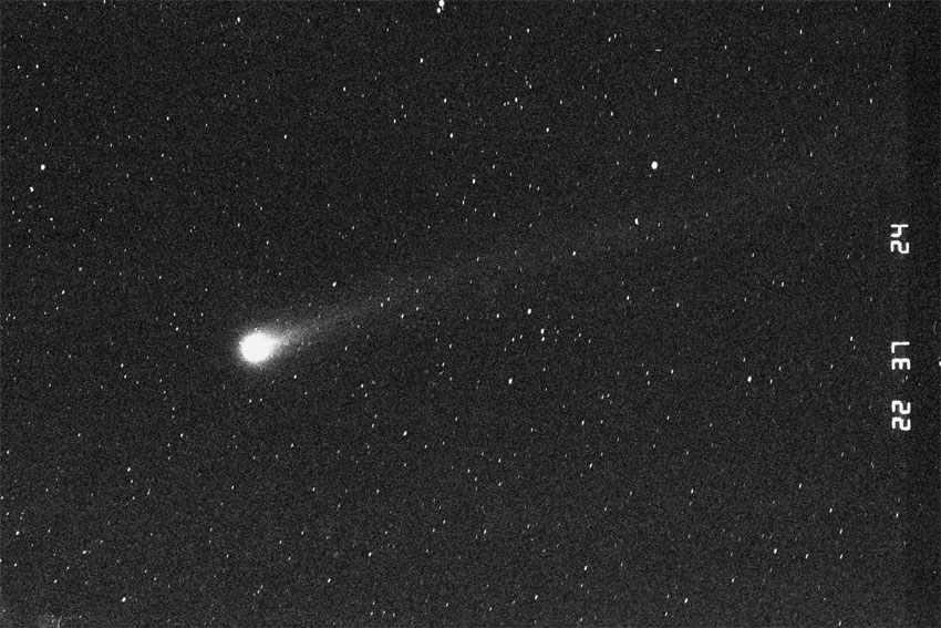

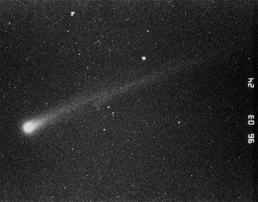

Sample images
Here are two examples of untracked (tripod) images, both processed in TMax-clone developer. One image was made using P3200 film as a 10 sec. exposure using an 85 mm f/1.2.
The other is a 30 sec. exposure made on Tri-X with a standard 50 mm f/2 lens. This 30 sec. exposure shows slight elongation of the star images owing to diurnal rotation. The camera is a Minolta-7000.
As the comet (Hyukatake) is an extended object you can see the performance of the faster lens records considerably more. Likewise the faster film improves the image but at the expense of considerably more grain.
At the time I made these images in 1996 I had no D-19 mixed and therefore used what I keep on hand, viz. TMax-clone (formula posted elsewhere in a recent TMax developer thread).
