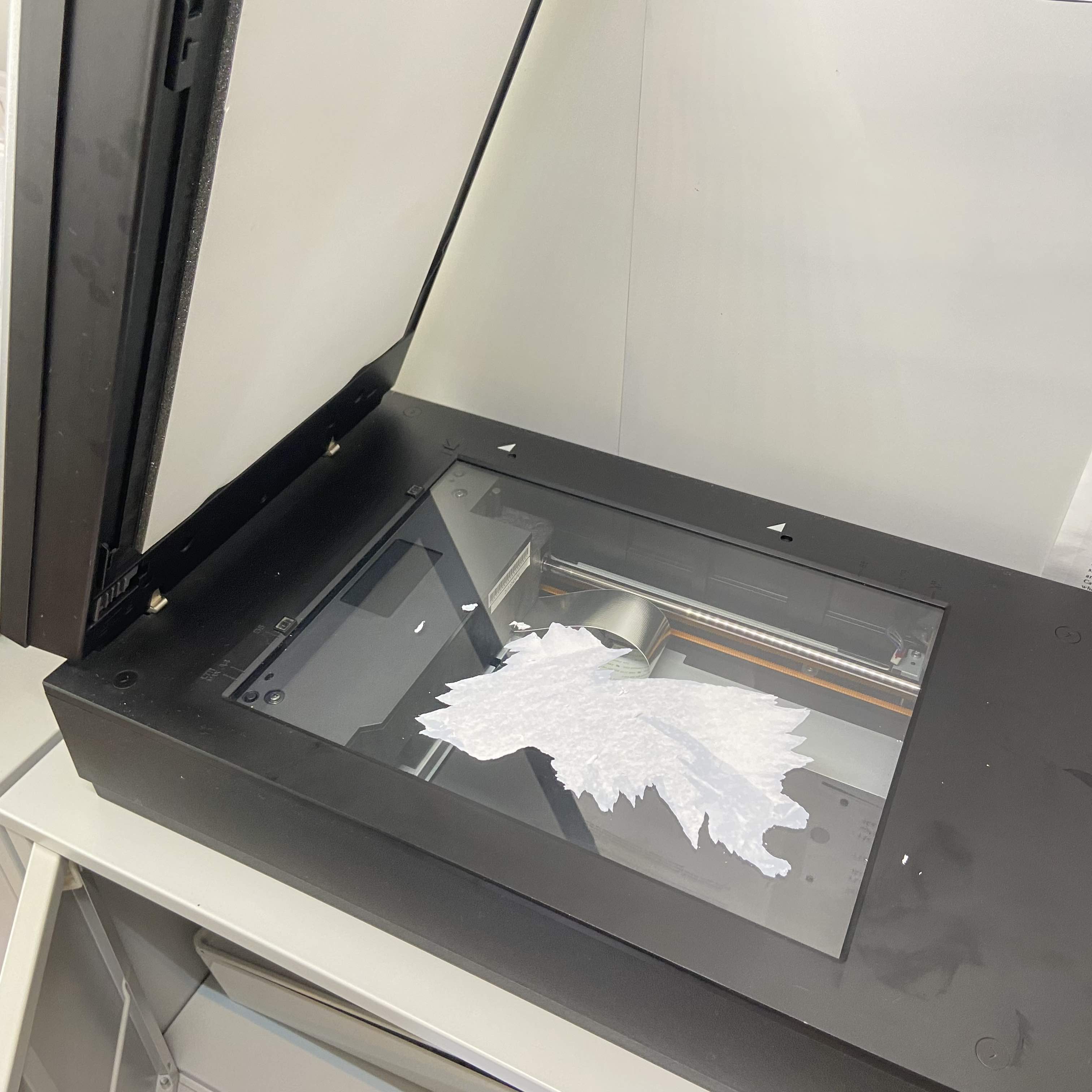

I stupidly left a not fully dried print in the flatbed of my V600 for a few days. The print was almost entirely stuck to the glass. This is about as much as I was able to remove, but it's near impossible to get the rest off with my fingernails.
Wondering if anyone has ever experienced this - if there may be a glass cleaner that helps to dissolve or loosen stuck paper? In terms of trying to scrape it off with a tool - might that help or might it ruin the glass? Or is this something that I might need to have professionally removed or have the glass replaced?

DO NOT use a SCRAPING tool. You didn't say if we are talking RC or fiber-based. Use a small DAMP sponge and place it on one edge. Place some paper towels around it to keep water OUT of the scanner. Wait a few minutes and see if that loosens up the part under the sponge. Use a soft "tool", perhaps a sponge or rubber spatula to remove what you can. If that works, Rinse and Repeat.

Thanks, I'll give it a try. I believe it's RC, it's an RA4 print.

That's RC -- Resin (AKA, plastic) Coated. That's going to take more time to remove. Isopropol Alcohol or Lighter Fluid might work faster than water, but only try those as a last resort. They won't hurt the glass, but the are more dangerous to the scanner parts.

Try sticking a similar piece of the paper to a piece of glass not the scanner to experiment. There are some goo removing liquids that might work

Wet the area where the emulsion sticks to the glass with a thoroughly wet but not quite dripping cloth by placing it on the affected area. Leave it there for half an hour or even an hour. Then gently wipe off the emulsion from the glass. If not all of it is easily removed, repeat the procedure.
You can add a little sodium carbonate to the water to make the gelatin muck soften faster.
Don't sweat, this will clear up just fine.

Can the OP remove the glass from the scanner. If so that would allow soaking the glass various solvents.

They make plastic paint-scraper type of tools for removing finishes on delicate surfaces. I have one from a kit for doing bathroom silicone.

My student did this to one of our V600 scanners! She stuck a fixed and barely rinsed print on the scanner and forgot about it. It sat over the weekend. I peeled off what I could, then laid hot, damp paper towel on top, with a book pressing it down. I left it like that for about half an hour, then repeated. I was eventually able to peel the rest off by rubbing my fingers over it, quick firmly. And yes, I did roast that student for her stupidity!

Thanks for the support and advice all, happy to say I was able to get it completely clean with the damp paper towel/peel off w fingernails method. Crisis averted!

Use a razor blade (found in hardware stores) that has the sharp blade on one side only. Get the paper saturated then slide the razor blade under the paper. Don't scrape, just use the sharp blade to lift the paper off.
