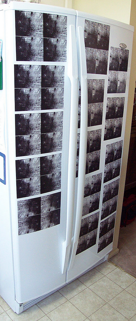

For up to 12x16 prints, I squeegee my prints on to the refrigerator door, and when they have dried substantially, I peel them off and stand them up in old style metal LP record racks to air dry for the rest of the time needed. \the air drying racks will do the job by themselves, but the flat surface of the refrigerator door speeds things up.
There are/were RC print dryers made for high volume environments like newspaper photo departments. They use/used warm air and moving rollers to speed drying. Some of them were aimed at Cibachrome
Here is my refrigerator from a few years ago, with most of the prints for an APUG (now Photrio) postcard exchange:
