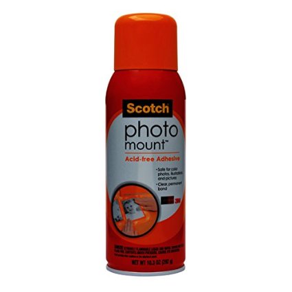

My favorite is 3M/Scotch Photo Mount Spray. I put some light pencil marks on the mount board, place the print face down on newspaper, and spray a nice coat on the back. Wait a minute or two, and place the print in position. Lay a piece of waxed paper over the print and roll down with a brayer. Even somewhat curled prints are fine. This stuff is really sticky. If some is on the mounting board or print, wipe gently with a cloth and some naphtha.
Thank you guys! Do nobody work with reversible glue there? I work with a film gallery here (Europe, Spain) So usually, at least here, it is very common to mount your photos for a specific expo, and than take it out( because are for commercial purposes, no permanently mounting , for archive reasons) This brand, that every one use it, is very "museum quality" friendly, for example: http://www.henzo-albums-uk.com/buy/henzo-photo-mounts/runners-refills-c-54_80.html. But this, is not very powerful for the paper that I already talked about it. So, if there is the same habit, do you have better glues?
