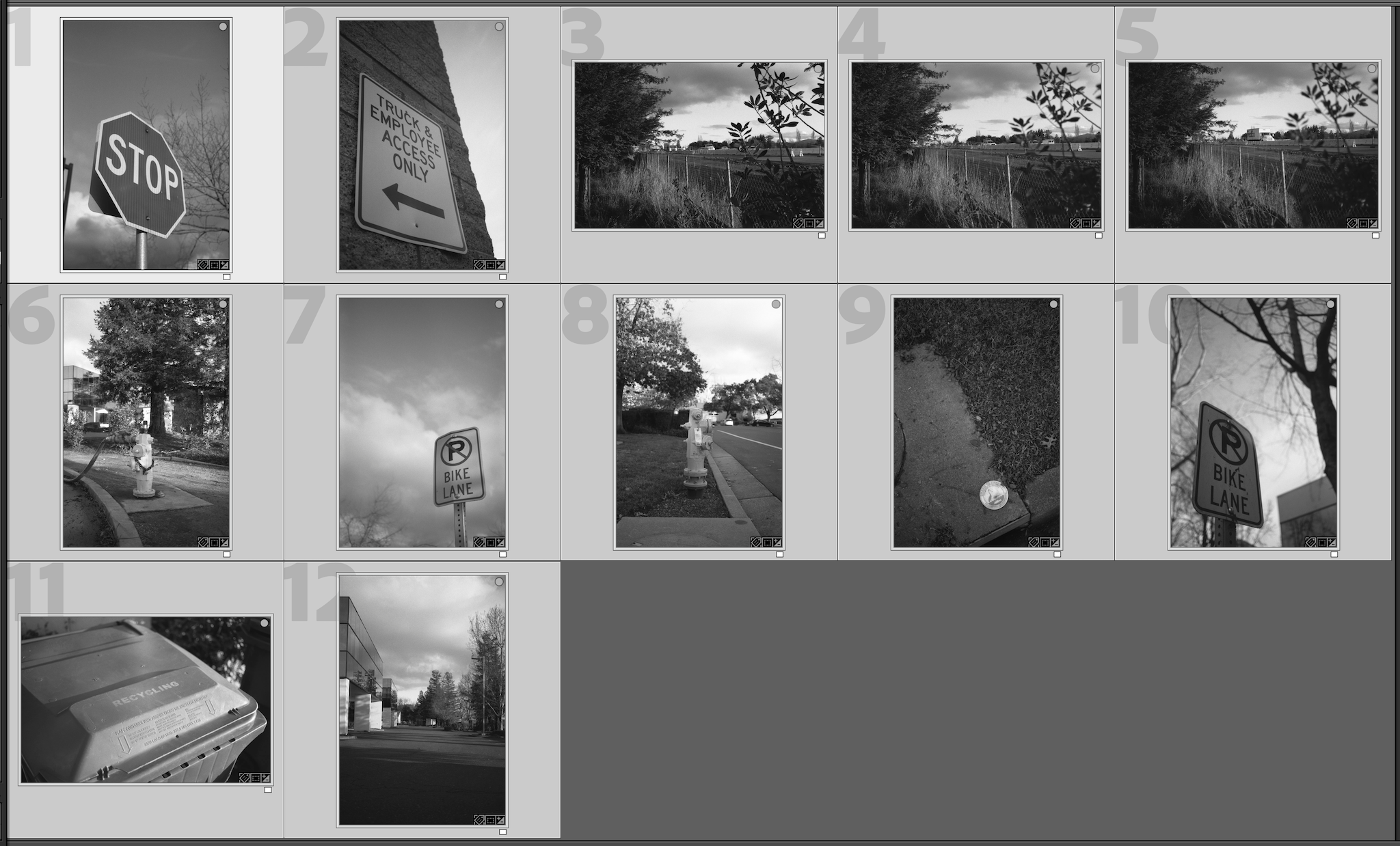

Update:
So I shot a roll of FP4 Plus to determine what Ilford's definition of "normal contrast" is. This consisted of an exposure of an 18% grey card correctly exposed via incident meter through a transmission rated lens, then the same, but +2 EV, -2 EV, and -4 EV, or zones 1, 3, 5, and 7. The gamma between zones 3 and 7 nominally comes out to 0.60. Based on just FP4, this is tentatively their normal contrast. I'll do the same exercise on HP5, and possibly Delta 100 to verify, though I doubt there will be much deviation. I made scanning profile for this gamma and scanned the roll in. Here's what the zones look like. #1 is film base plus fog, #2 is zone 5, #3 is zone 7, #4 is zone 3, and #5 is zone 1.

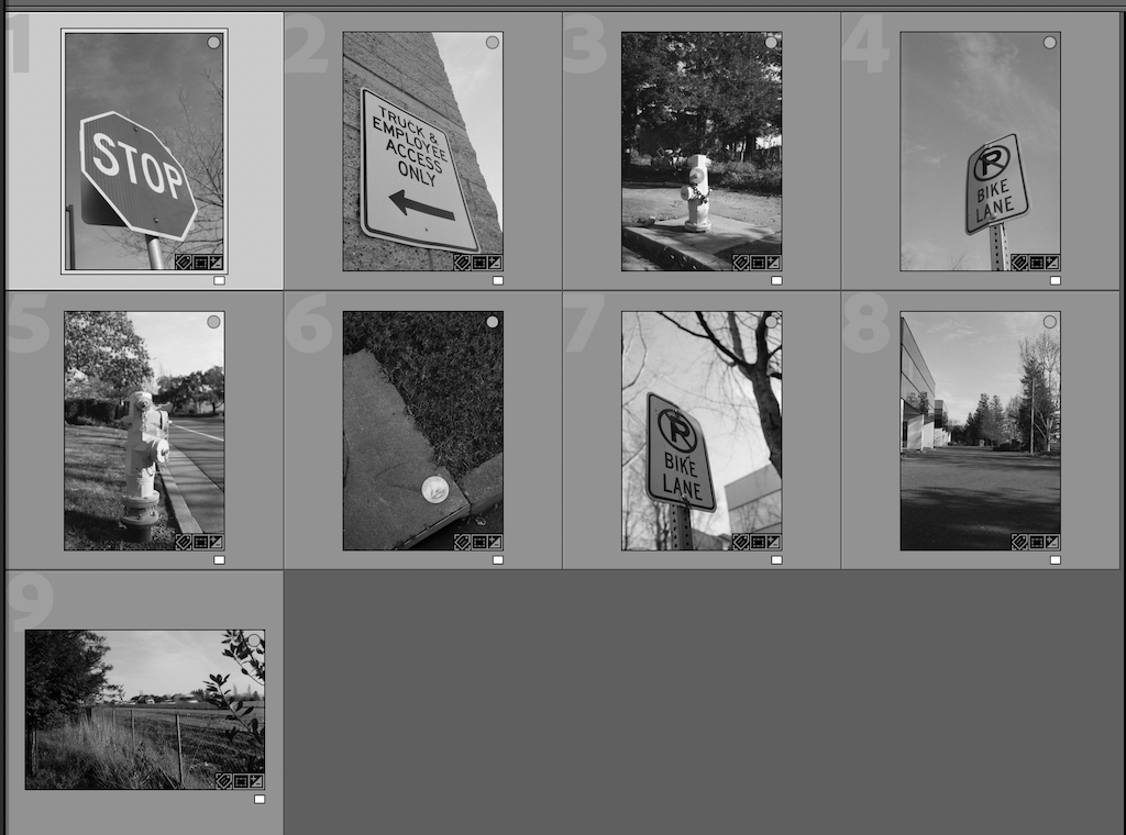

Here's the sample images, scanned in with the profile. I used a Canon A2E with Canon's 40mm STM prime lens, stuck it in AV mode and took a number of standard pictures I take outside my business just using the camera metering and basically doing point and shoot. This particular camera tends to under expose by about a third to two thirds, so I adjusted the exposure of each frame and spotted out a few of the more egregious chunks of dust/crud. Other than that, this is basically a straight scan.
For those of you who use Adobe Lightroom or Adobe Camera Raw, here is a link to a zip file that contains the resulting DNG files if you want to look more closely at the grain, tonal range, etc: http://m.avcdn.com/sfl/FP4_PLUS_ILFOTEC_DD_DEV.zip. The scans were generated with a Canon 90D, Sigma 70mm Macro ART lens (the new one) and a strobe for the light source and turned into positive images with Simple Image Tools and the scanning profile with the 0.60 gamma.
Enjoy.
