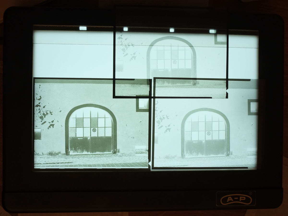

Here are the results :
Left sheet is a test while increasing exposure strips, both with base exposure and flash exposure.
It moved slightly during successive base exposures, hence the obvious blurring.
So, finally I got something which looks like a negative, probably too dense for using in alt-process, but that's a begining, and probably a matter of tuning Base exposure and flash exposure.

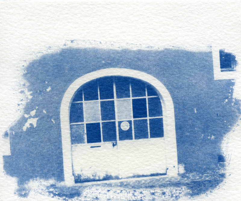

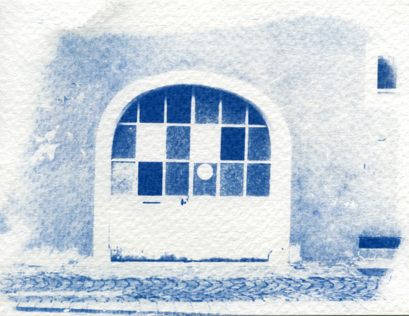

As I supposed earlier, the enlarged negative I got has too much density to be usable for cyanotype.
I can scan it, even do a contact print with it, but I got a blank square on sensitized paper when exposing through a reasonable amount of time (with a BL exposing box)
During the following days (or nights in the darkroom), I perfected the workflow, trying to change
a few parameters at once.
For example, I read that original negative with a weak contrast aren't advised for. The first negative I tried, is indeed, not very contrasty. So, I tested different source negatives, you can see a few sample of the results here :
Process seems now to be well driven, however, I still get too dense negatives for alt-process.

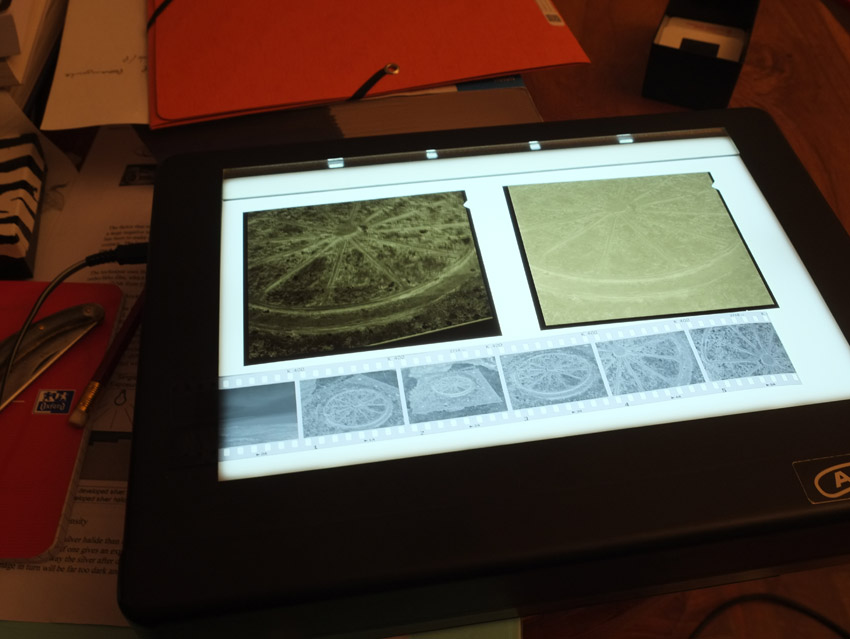

Another question I raised to myself is about the Ortho film I used until now. I bought the box long ago (it has an expiry date of 2009), and it was stored in coolness, but not into the fridge.
So, how a certain amount of "aging" fog renders when reversing negative through this process ?
I would guess intuitively that it induces a less dense negative, but is this right ?
Then, the thought came to me that I have indeed another Ortho film in stock, hopefully fresher. I bought a few weeks ago a box of Wephota F05 film, in 4x5, just by the sake of curiosity rather on purpose. Not much technical data are provided, I only know it's orthochromatic.

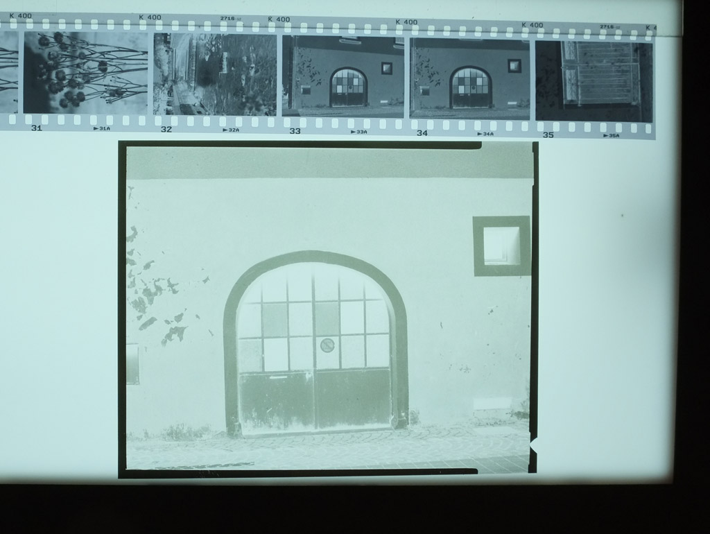

Let's start exposing a test view with this. I loaded a Fidelity holder with one sheet, and exposed the same time I already used for the Maco Ortho. Now, handling a 4x5" sheet through the different trays, first in total darkness, is not a common thing, even it's still a "small" format. The sheets seems heavy, slippery and fragile. I truly got the feeling things are going serious !
With the same exposure time, I got a nice, rather detailed negative, in 4x5", but still too dense.
After a few days, I decided to "print" another test sheet, with a few secondes increase of Flash exposure. I loaded the holder, exposed it, put it in pre-wet bath, and... What the heck ??? Why this sheet seems a lot more physically thinner than the first time ??? And more and more strange, later in the process, sheet is almost completely blank when in bleaching bath... It turn almost completely black, after 2nd development. So logic ! Since first 4x5" try, I only slightly increased flash exposure. The completely black sheet result means that it was very under-exposed. I was going to bed completely puzzled, and wasn't able to find a plausible explanation the following day.
First possibility that came to mind, I loaded two sheets sticked together in the holder the first time. But, then, why the second attempt seems a way lot less exposed ???
In the evening, I decided to look carefully to two sheets of resulting negs side to side. Ahem...It hits me in the eye : outside the thickness, notch codes aren't the same, that obviously not the same film !
The revelation stroke me : I mixed boxes of films when loading my first 4x5" sheet in holder. On my lab bench I have also an opened box of Kodak Portra 160 VC color film. In total darkness, I mixed the boxes, and I loaded the holder with a color film instead of an Ortho one ! Stupid me ! I confirmed the culprit looking at a color negative I had.
Still no exploitable negative for alt process, but I demonstrated at least one thing, by accident : it's possible to use color negative film to enlarge a B&W negative :smile: I understand roughly why, as color films are indeed on a B&W basis, but what about the pigments ? But maybe one of our photochemical experts would add further explanation.

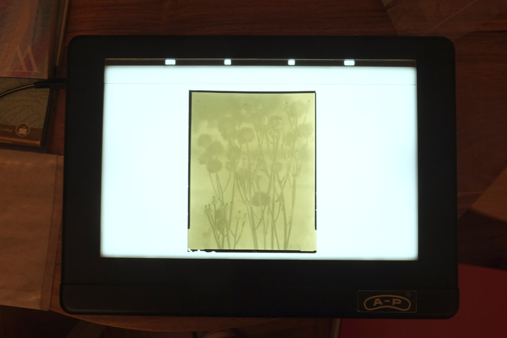

Not enough to be worried about! But of course, as you said above, it'd be much better to have all the parameters "as fresh" as possible.

I refined this time with a few more tests. The main difficulty is estimating if a negative got correct exposure while holding, a fresh, fully processed, wet sheet onto the light. Indeed, I discover that a negative can seem, at the first glance through the wet sheet, too thin, but come later as a suitable negative for cyanotype printing. And, maybe it's false impression, it seems going denser after washing+stabilizer.
Here is my first "exploitable" result, from, the shot #34 on 35mm negative.
Another point is, with my setup at least (light output of enlarger) , the relatively great impact of a small variation of exposure time (1 or 2 secondes) on contrast and printability of resulting negative.
Here you can see a few examples, will only a small variation, from 1s to 2s of flash exposure (two negatives from the lower row, they got same base exposure).
Well, it's time to show here what I got while cyanotyping.
Negative #1, 40min exposure on Canson Montval paper.
Negative #2, 40min exposure on Fabriano Aquarello :
This paper it's a first try for me. Obviously not the better paper for cyanotyping (blue is often turning pale/greyish after drying), but its mottling can offer interesting effects.

BTW, I'm currently working the next step for me : enlarged negatives on 13x18cm X-ray film !!!
