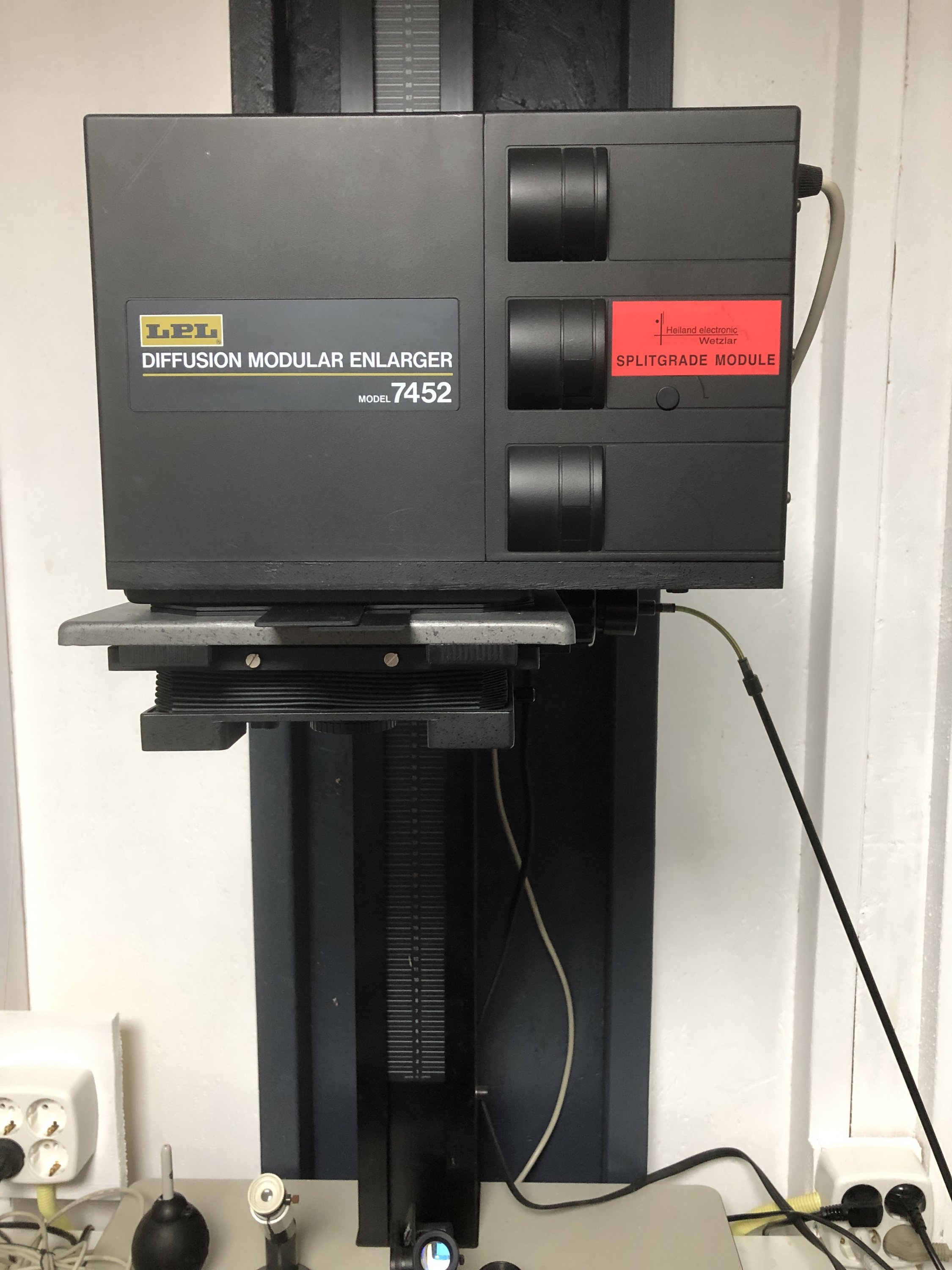

LPL is a good choice. Got this one on a local auction site for €300 including the split grade controller and a lot of other stuff.
Regards,
Frank
