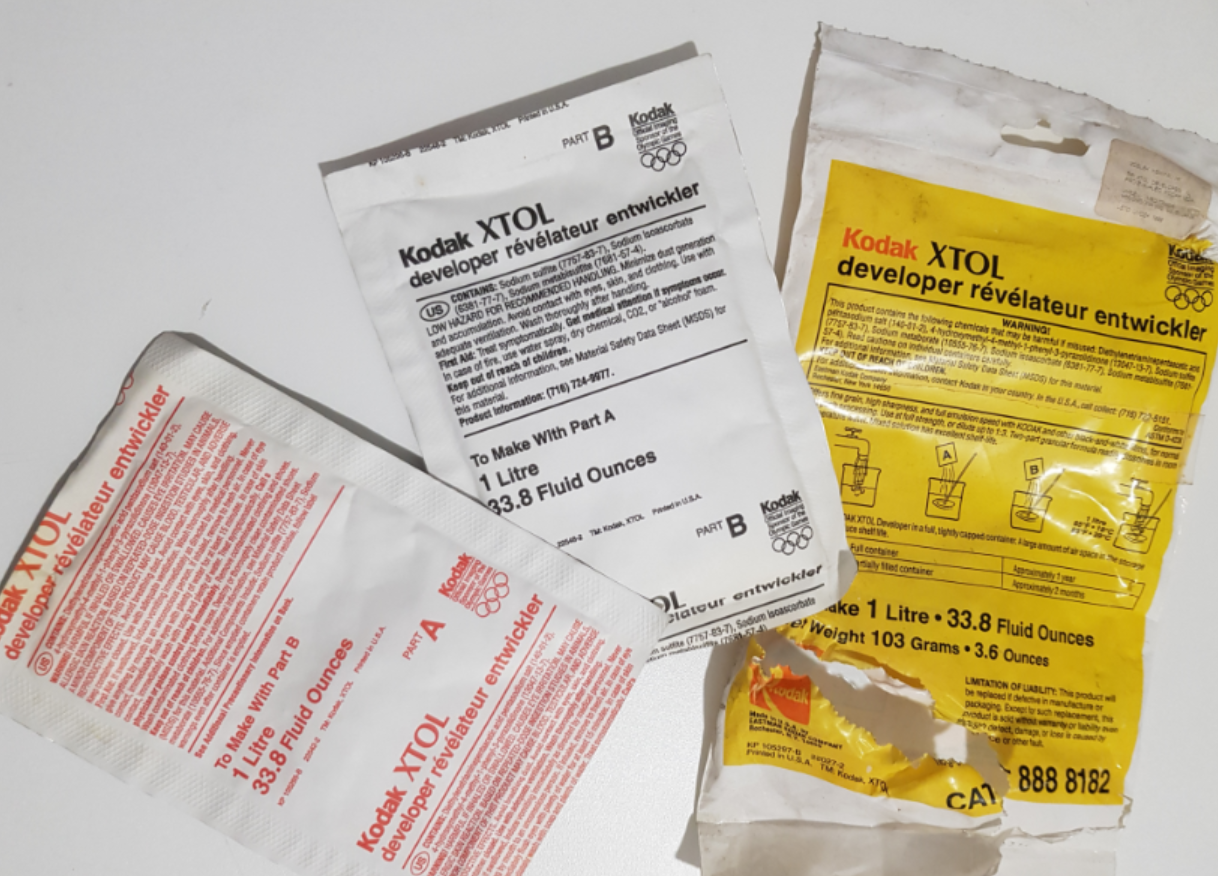

Kodak did make Extol in a 1 lit or quart size when Extol was first released. I stopped using Extol due to the sudden "death" issue which Kodak fixed and Kodak stopped making the smaller version.
It was sold as a 2x1L pack; I'm still keeping the "other half" I purchased in 1999, as a souvenir. Here it is:
