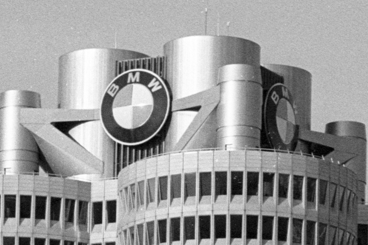

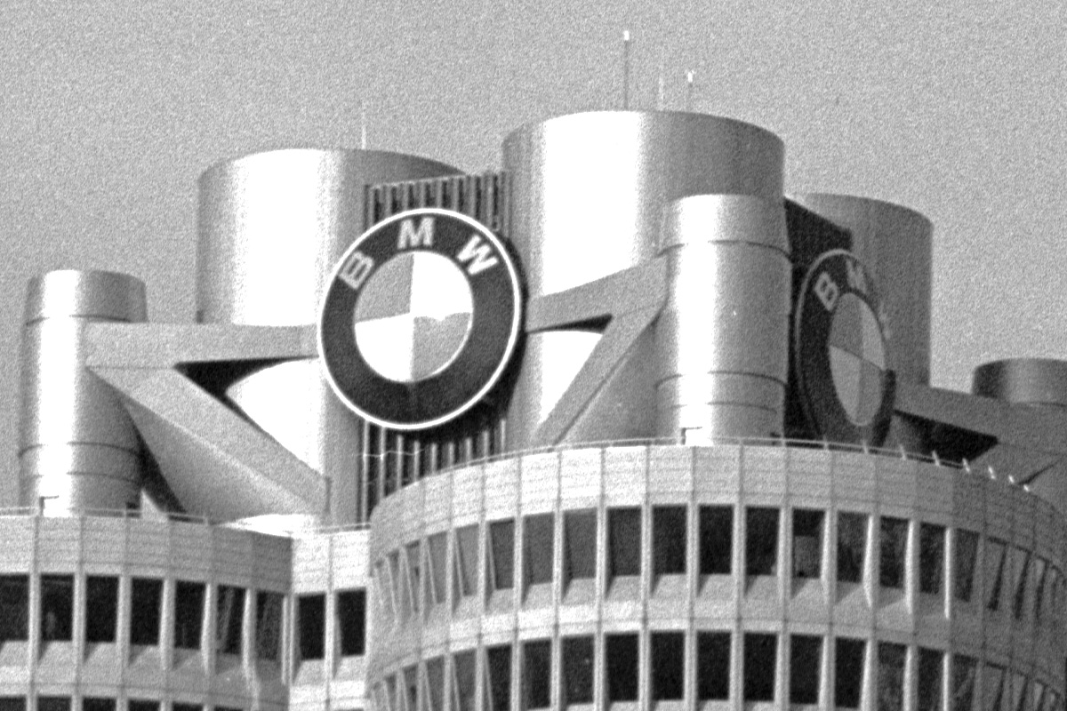

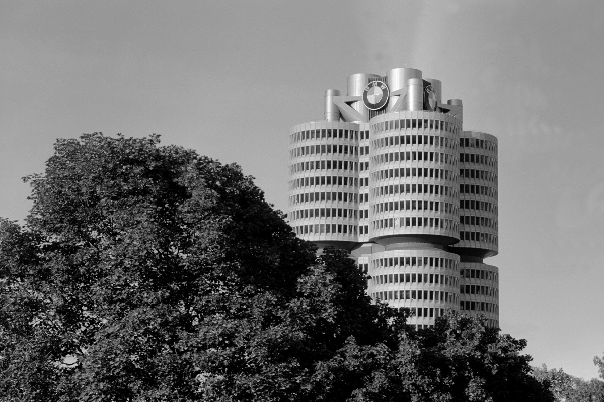

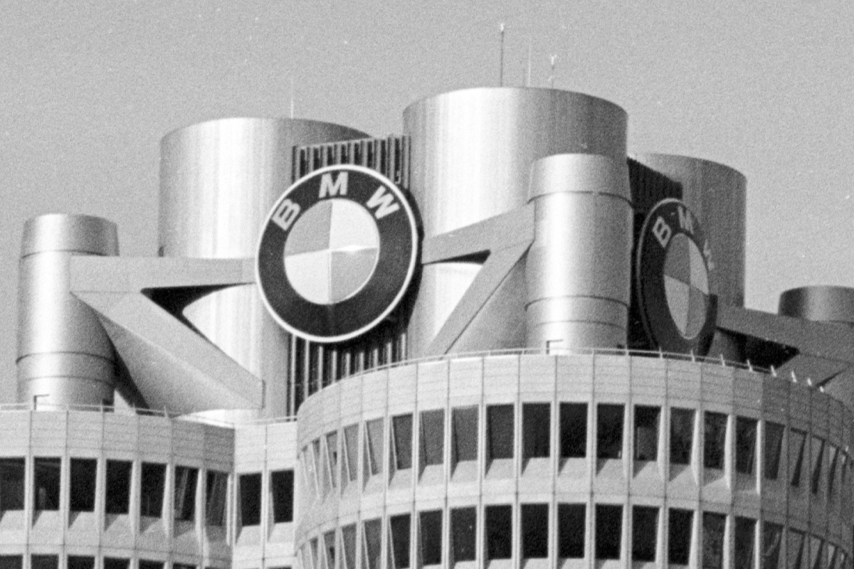

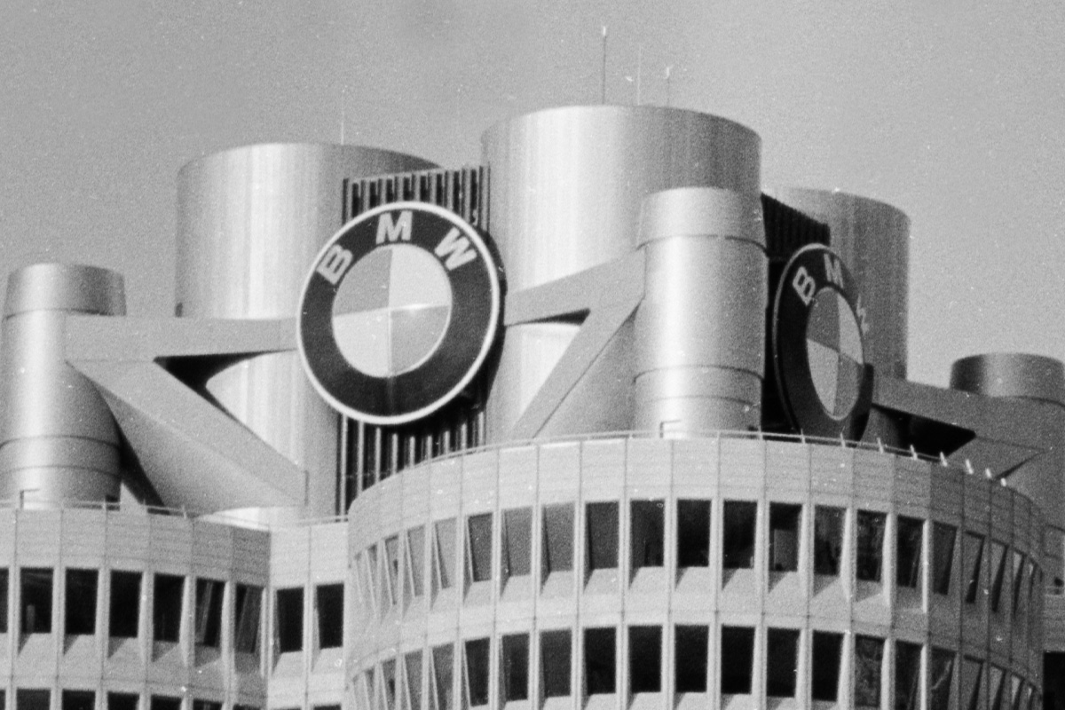

I had a try with the Silvermax a while ago and was not at all impressed. As usual, I did a 1h stand development in Rodinal 1+100, but the film came out with quite unpleasant grain and coarse tonal values. The emulsion is said to be similar to the old Agfa APX100, but I am not really sure. APX100 worked very well with Rodinal in stand development.
I did a new attempt this week with the film and have now tried a few other developers. When pixel-peeping the scanned negatives, I feel confirmed, that Rodinal does not work very well with this film. Both ID11 (stock, 9min, 20°C) and the Silvermax developer (1+29, 11min, 20°C) give very nice negatives with smooth grain and tonal values. Using these recommended times, the negatives out of the Silvermax developer are quite a bit denser with much better tonal rendition in the shadows, but still without any blocked highlights. Increasing the time for the ID11 developer might give similar results, but from what I see right now, I would actually prefer using the Silvermax developer.
Here, the entire image developed in the Silvermax developer.
100% crop from this image (Silvermax developer):
100% crop, ID11:
100% crop, Rodinal 1+100, 1h stand development:
100% crop, Rollei Supergrain developer:
I might get to try some of the odder developers tomorrow. I have a few Spur developers and PMK here, which I would like to try.
100% crop, ID11:
Unless you specify the means of scanning, those results mean little.
Mar 21, 2017
173
Germany
The snippets were ment to show how different developers affect the grain. I am not sure why you think the method of scanning is relevant, but if you want to know, I scanned the negatives on a Nikon Coolscan 4000LS with all optimizations (grain reduction etc) disabled. My experience is that such scans then appear very similar to what I get when printing the negatives traditionally.
Lachlan Young
Dec 2, 2005
4,845
Glasgow
I'd suggest that the grain aliasing habits of the scanner, its ability to handle denser highlights without clipping & the abilities of the scanner operator may all distort the final results & consequent claims much more so than the differences in developers - if the development times are controlled to produce the same EI.
Either way, it's clear that the Rodinal negs are significantly overdeveloped compared to the Silvermax/ ID-11 ones in terms of highlight density - and I guessed it might have been a Coolscan that was used, but for reasons far too arcane to delve into.
Mar 21, 2017
173
Germany
I have not wet printed these images yet, and I am not sure if I will, but my experience is that the visual 'look & feel' of B&W grain from the Coolscan is usually very similar to how the grain looks on an analog print directly from the negative. I have printed some of the first photos I shot on Silvermax and stand developed in Rodinal and believe me, the grain on the print looks just as ugly as here on the scan.
