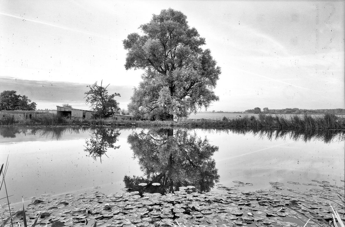

What I did was following:
Took my Cambo wide on 58mm SK Super Angulon XL and rolled a 6x9 format 120, shot at f16: iso16, iso20 and iso 25.
Then I took 1:100 HC-110 and mixed with 1:100 Rodinal in a 500ml reel and developed for 8min.
Always difficult to judge the negative, but seems like the iso16 one has excellent contrast and still some shadow detail. Will post the result after the scans.

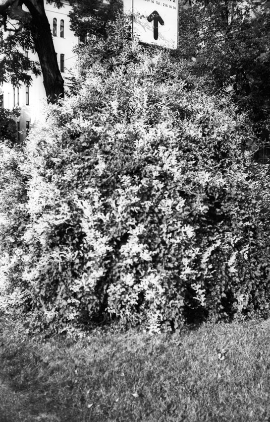

Here's my result, the 'spots' are from calcium, next time I need calciumfree water through the whole proces.

if you want even more contrast try the orthofilm with rodinal 1+10 develop for 5min @ 20 degrees celsius and shoot it at 25iso - this will give you a very highcontrast picture with almost no grey - pure black and white
it would look something like the picture i added
i took this photo with the maco/rollei ortho 25 but i tried the adox aswell
both are very similar with this development

@belichten, I like the contrast, let me shoot another roll and try your recipe as a starting point. Thanks.
