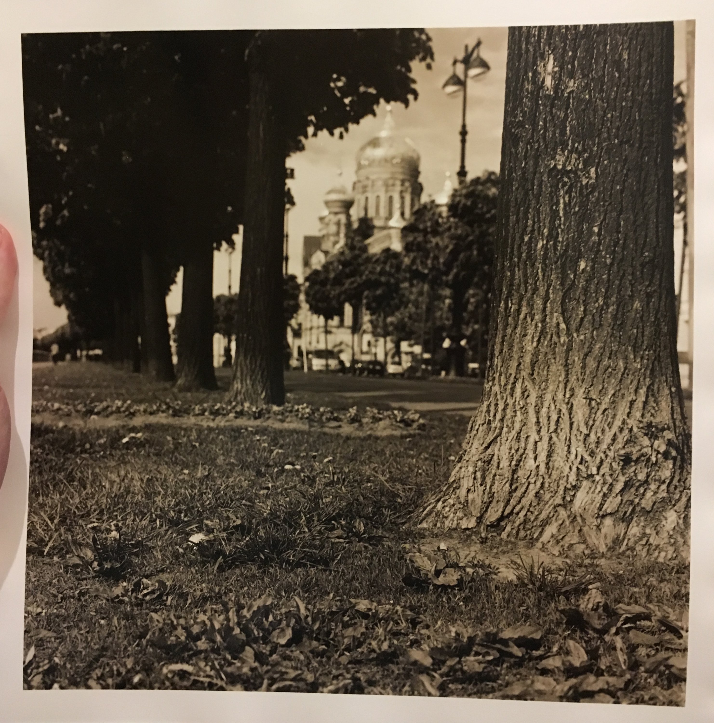

In my experience Adox MCC does change the colour of the print when selenium toned. I'd say it has similarities with Ilford MG classic and I really like this paper split toned (sepia / selenium).

That split toned result looks very good. I've not had a chance to do much printing with the MG Classic paper, I still have some MGIV paper to use.
