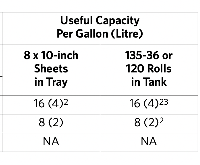

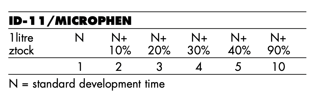

By reusing the stock solution. As you mentioned, Ilford recommends adding 10% development time after each film for ID-11. You get up to 10 rolls with this.
Kodak's D-76 instructions aren't quite the same. Their recommendation is adding 15% per roll, but only after the first four rolls are processed. This brings you to a total 16 rolls per litre.
Important to note that the used developer always has to be mixed with the unused part after each film developed.
Kodak D-76 (info on page 5 of the data sheet posted above by Luxaeterna) :

Ilford ID-11 (page 8 of data sheet) :

16 is the maximum capacity per gallon, not per litre...

The J78 document cites a quart/liter pack used at full strength with reuse gives a capacity of 4 rolls per liter.
Below the Storage Life and Capacity table we read
“If you use D-76 Developer diluted 1:1, dilute it just before you use it, and discard it after processing one batch of film. Don’t reuse or replenish this solution. To extend the useful capacity of D-76 Developer diluted 1:1—when processing two 36-exposure rolls in a 16-ounce tank—increase the recommended time by about 10 percent.”
16 fluid ounces = 473 ml. Thus, a liter of stock D76 diluted to 2 liters (1:1) could process 8 rolls of 35 mm film.
This works for short 35 mm reels. But the taller 120 reels require move volume to cover them.
