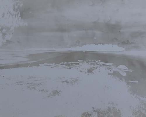

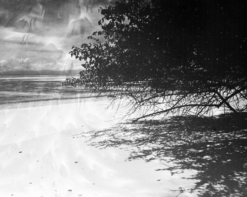

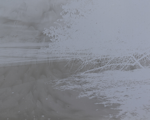

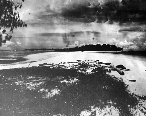

Just developed Adox 20 (EI 12) in pyrocat HD two baths: 1+15, 5 minutes for both solutions. Scene was extremely contrasty: white sand, tropical sun.
Resulting negatives are extremely thin and with a strange pattern (see the positives), not sure where it is from. However doesn't seem to be staining form water drying up. Any idea where could it come from? I still have 4 virgin rolls of this in the fridge, any idea how I can improve the process (without changing developer)? I am thinking to make the solutions more concentrated like 1+10 to increase contrast and maybe a bit more time.

Thank you for the ideas! I actually would like to improve the overall tonal range and obtain bit denser negs...therefore more exposure E.I. 6, more diluted solutions (1+20 for both) and same development time, do you agree?
About the apparent non uniformity of the development what could be the cause? Here (http://www.pyrocat-hd.com/html/TwoBathPyrocat.html) they suggest to add a couple of drops of photo-flow to the development solutions...could be that simple?
Cheers,
Ferru
I recall it's extremely sensitive to poor agitation etc - & being a document film, its grain construction/ makeup is somewhat different to a more standard film. By using in this way (for lower contrast etc), you're taking it quite far outside its original design parameters, thus weird & inexplicable artifacts can happen quite readily. I'd be inclined to follow the agitation routine that the adotech instructions recommend.
Cheers,
Ferru
You want thin negatives. Unlike other films the grain structure of agfa microfilm means that you can actually fog the highlights by over exposure (in my very basic understanding of an old essay on the film by the guy who did the spur developer). Latitude of exposure is extremely limited.
Having had negatives exactly like yours from my first roll those have been way overdeveloped and from the marks also underagitated so i would say you have reached a dead end with that developer film combination and you need a total rethink.
Of course this is just from my very limited experience
