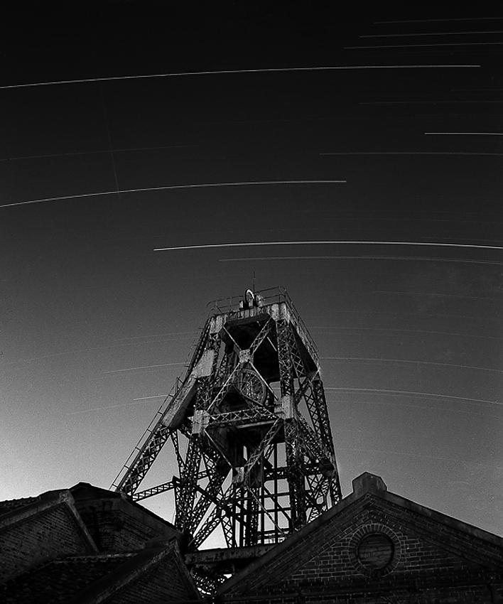

I thought I'd apply a little "speed boost" technology to this film, like Adox's HR-50. It's nothing more than pre-exposure...It's easy to do so, why not?

I did light paint some buildings during a 5 hour night exposure, with a flash set to strobe...I also climbed up under the tower and blasted it for a bit.

In your shot ín #9 there appears to be a person kneeling on the top with a head through the guard raíls It looks like a nun, possibly praying for your safety or soul in case the safety prayer fails?
Either that or Fay Wray wondering what had happened to King Kong when he fell

Andrew, it must be my eyes and brain. First I see a nun on a tower and now in your pictures of the tree and background building I'd give up the extra shadow detail in the pre-exposed negative for the overall effect on the building in the background which looks better to me with the non pre-exposed negative
I suppose it all depends on what part of negative has the most value to the viewer. Nevertheless it's nice to know it can be done and how to do it
pentaxuser
I will never be able to unsee that now 😁
