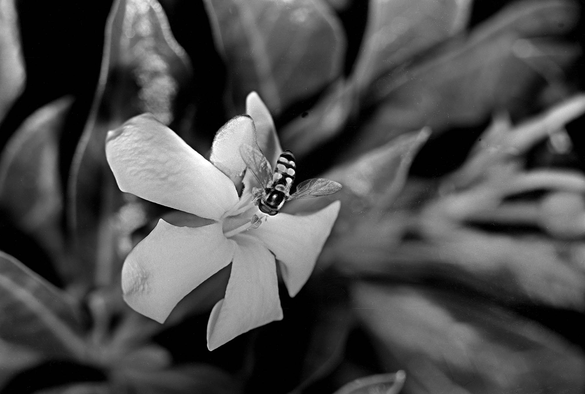

I shot off a roll of high resolution cms20 ii film exposed at 10 iso and processed it in rodinal at 1:500 dilution at 17 degrees C for 2hours using stand development. I wanted to see whether I could get a range of tones without using the expensive adotech IV developer. The negatives were very thin and the developer exhausted itself in the highlights giving a brown colour to them. However the negatives exhibited a good tonal range. I have attached a photograph taken with my 100mm macro rokkor at f/8 with flash lighting of a hoverfly on a native (Australian) white frangipani flower.

At 1:500 dilution what was the amount of concentrated Rodinal used? Is this a scan of the negative and if so how much post processing was done or is it a scan of the darkroom print which replicates the prints exactly or as closely as possible?Thanks

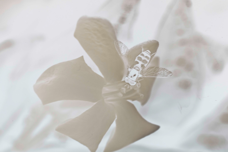

I’d love to see a photo of the negative, to see what “very thin” is. I haven’t tried CMS II because the cost of the developer. If I could get something usable with developer that I already have, I might give it a try.

It is a scan at 4000dpi and reduced in size.

Hi- here is the photo of the negative you asked for it is taken into the cloudy sky with a nikon D500 and 105mm manual micro nikkor and hand held - I hope it meets your requirements.
Cheers Peter

1ml concentrated rodinal to 499ml of water. I placed the 35mm roll (36exp) in the 500ml of solution. The post processing was minimal I removed some dust spots and applied a small amount of sharpening.
Thanks. I asked the question about dilution because 1ml seems generally to be considered too little although if you are solely a scanner then a thin neg may be OK. As there was little or no post processing and if you are a hybrid worker, then if the positive, as shown, can be turned into a print of matching quality then everything seems to have worked out fine

Your results are remarkable, however I wonder if you have the corrrect negative. They look really close but there are some suble differences. The major one for me is the upper left corner/quadrant. The negative has a large space of no density but the print has plenty.
A good observation, Steve. Yes the insect has appeared to have moved, based on its wings in relation to the petals. I thought again about 1ml + 500ml and it prompted me to look up an article by Ed Buffaloe on Rodinal. According to him Agfa recommend a minimum of 10ml per film but he says that he found 5ml was sufficient. However Peter is using only a 1/5th of what Ed Buffaloe regards as the safe minimum.
I suppose that even if the neg is not the one from which the positive was scanned, then as long as it looks similar this may not be relevant I'd be very nervous of only 1ml of Rodinal but that's just me

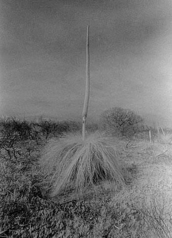

I used to print "thin" negatives on Agfa Brovira Gr6 paper when I developed Kodak infrared and TMax 100 in Beutler developer and they gave nice results albeit grain was apparent but the sharpness was fantastic. I have attached an image of Kangaroos and a grasstree in bloom taken
with Kodak IR bw film both developed this way.
cheers Peter
