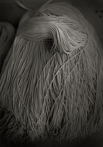

Adox CMS image
ASA 20
Adotech developer
40 year old Nikon F
with 40 year old 24mm Nikkor N
2.8 wide open
handheld
kram
kram
Jun 4, 2006
106
Nice image , lovely tone. Just shows what these really fine grain films can do.
