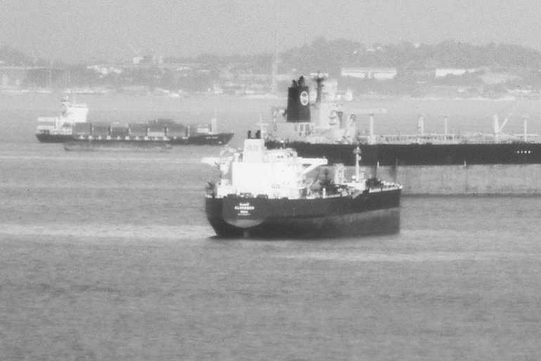

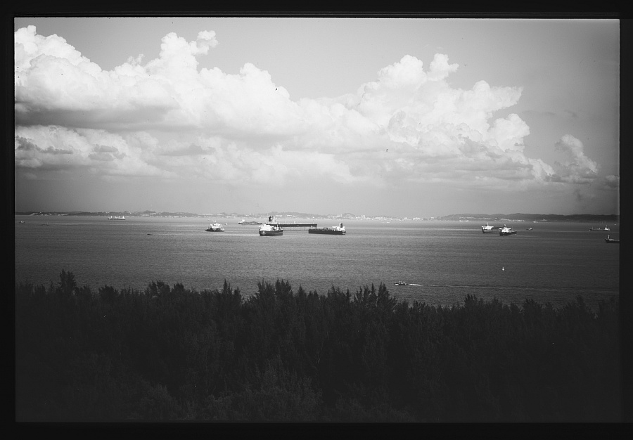

Here's a sample of CMS20 reversed by DR5, scanned on an Imacon. Second image is a 1:1 crop @5000dpi.

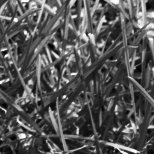

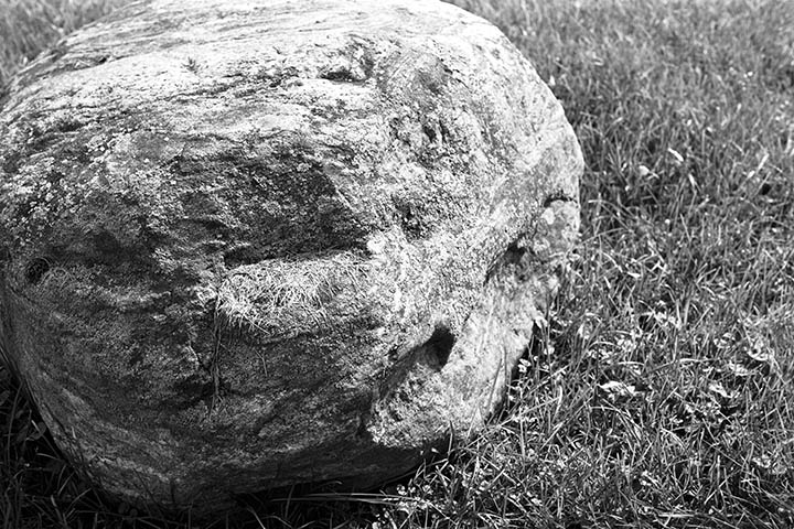

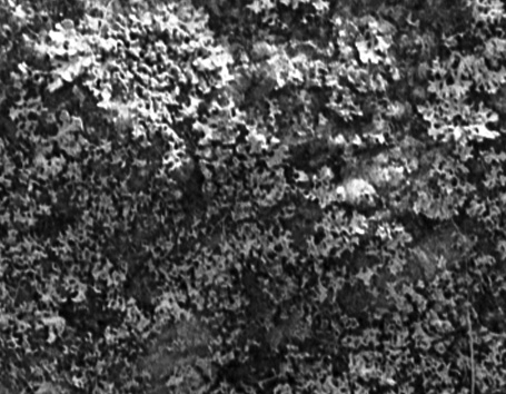

I've picked up a scan from the negative today, and here are the results. The first picture shows the entire image; the second one is a detail from the grass on the right hand side, at the bottom; the third one is a detail from the lichen on the rock, center of picture.
Developer was Adotech 1+24 for 5.5 mins; camera is a Spotmatic F w/ 50mm SMC Takumar f1.4, on a tripod. The original scan is 7200x4800 pixels.
I think I overdeveloped a bit, but not by too much, and that was a rather contrasty scene anyway.

Thanks! I think the resolution of the film is a rather scary power, but I'm interested to see how the tonality of it holds at large enlargement, because that is the point anyway for me. I'll try to enlarge some shots to an 11x14 to see.
