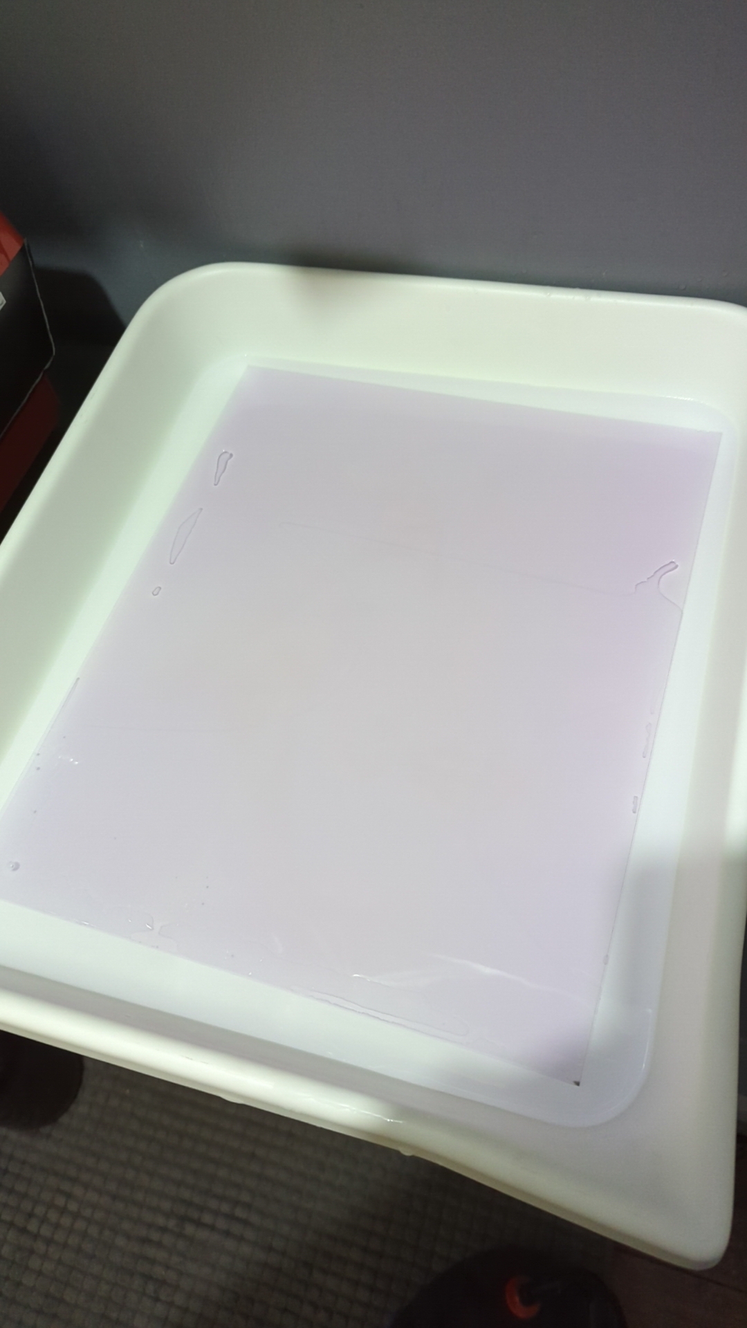

Hi folks,
Sharing my really bad experience with Adox CHS II 100 14x17 sheet film.
I purchased three packs from FotoImpex late last year and started using them these past weeks.
From the packs I noticed several alarming issues during film loading, first up, I noticed that the paper sheets inside left some powdery residue on the negatives and on my finger tips. These are black paper sheets that kept the negatives apart from each other.
What's worse is that within the packs, most of the negatives didn't have notches! Which made it difficult to know of course which orientation you should be placing the sheets inside your film holders.
This is 14x17 ULF film, and it's not cheap, more so coming from a supposedly reputable brand!
Now for those that had notches, I loaded them and went on a long planned location shoot for two days, and alas, I didn't expect things to get any worse, all the negatives I shot turned out blank.
Now upon contacting FotoImpex, I was informed that this format was discontinued by Adox—I wouldn't be surprised why.
Never again—I do not recommend purchasing from Adox.

Dear Jurgen, we are sorry that you had a negative experience with our film, and we would like to resolve this case, as it is quite unusual. We also went to instagram, and have seen your message, which was sent 12 hours ago. We apologize for not replying earlier, as we first have to investigate such issues with the production team, and the reply might take up to two working days. Be assured, this matter is taken seriously.
What should be noted first, is that we did not stop manufacturing 11x14 film in general. There might have been a misunderstanding in the communication. It is true, however, that we cannot remanufacture this specific CHS 100 II film in this size for you, because the raw material was sourced from a company that cannot supply it anymore.
As for the blank negative, It is pretty much impossible that, after correct exposure, the film turned out transparent. We cut a lot of different formats from the same roll, which has the same emulsion from the same coating, and we always do quality control of each "cutting" for light leaks, dust etc. We would know if something was wrong with the emulsion itself.
How the film could turn out blank, is if it was inserted the wrong side into the holder. Which is easy to happen if the film is missing the notches. On one of the pictures of the negatives you sent on instagram, there seems to be a very faint image, which could be an indicator of this exact issue.
Of course, having missing notches on the film is not acceptable. We are using vintage equipment for film production, which does, unfortunately, produce mistakes in very rare cases, especially with larger formats. Thank you for bringing this to our attention.
We would like to offer you three solutions:
1) You send back the films, and we reimburse you the purchasing price and the shipping costs
2) You send back the films, and we re-notch them for you, of course reimbursing the shipping costs
3) If the pack is partially notched, you can mark the side of the notch on your box, and use the film as it is. All the emulsion-coated sides are always facing one way. In the instagram messages, you mentioned that you used the notched sheets. Might there be an error in the loading? If you try loading the opposite way from which you did it before, quite surely the film will work. We will, of course, reimburse/give credit on future purchases for the lost sheets.
Please contact us through the same fotoimpex email you used in the previous communication, and we will be happy to proceed with any of the three options.

It's 14x17 sheet film, not 11x14.
I always double check film before loading them on holders and before putting them in drums for developing and the negatives were loaded properly.
I do appreciate you responding, and thank you for providing options, do understand though the frustration and time + effort wasted especially to those who were contracted to be part of the project—this was a two-day boudoir session on location.
Can you please send me your direct email contact as I haven't gotten a new reply on the email thread prior.
Should be pretty easy to test if your film really doesn't register no light at all.
Btw, what is a small area of density in the lower right corner in the shot of your supposedly properly exposed and developed sheet?

We have two claims here, one of which (film has no emulsion) is technically next to impossible from a manufacturing standpoint. If this film was inserted into the negative holders the other way from like it was inserted before, it would expose. The other (film has bad notches) is technically imaginable, but has never been reported to us so far. This is the first case, and we suspect it might be because of the extra-large format and the machine limitations.
We offer solutions in order to help the customer keep shooting this rare format, and investigate and improve on our end.
This is a standard procedure among all photo manufacturers, to ask for the claimed product to be sent back. We cannot investigate, improve or give suggestions to the customer without having the product in our hands.

Hello, thanks for the response–just to clarify, I purchased three packs of 14x17 Adox, and it's just one pack that seems to be problematic, I have developed a sheet from another pack during the same shoot and it was okay.
As for the emulsion, my pre-wash during development suggests that there is. My assumption here is that since this particular pack had some sheets with notches, and most without, might it be possible that the notches were placed erroneously, which means, even if I loaded correctly, the emulsion side was facing the other way.
I do appreciate you reaching out, but since you don't make this size anymore, I can't seem to imagine what's the most economical way to resolve, the film is nice don't get me wrong and I like it, but I can't seem to wrap my head around the QC issue for this particular pack.
But, you need to invest less than 5min of your time to check if there is really no light sensitive emulsion on the film, right?
What am I missing?
I have IR goggles, the emulsion side is a blazing white under IR. Easy to identify, no notches would be impossible for me to keep straight without the goggles.
What am I missing?
There is light sensitive emulsion for sure, as suggested in my pre-wash before development—the assumption by me and the team from Adox is that the suspect pack might have had misplaced notches, as most of the sheet didn't have notches to begin with—basically, even if I loaded the film as it should, the emulsion side was still facing the other way.
Even if you loaded the film incorrectly because there were no notches, how is it possible that absolutely no light made it through the base to the emulsion?!
That's why I'm asking what am I missing? Does this film have a 100% opaque layer under the emulsion that would prevent ANY exposure when shot through the base?
The antihalo is pretty strong, yes. This is not a greybase 35mm material. We apply an antistatic/ah on the back (see technical datasheet). You can´t really shoot through there.
