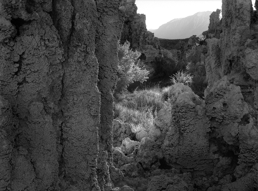

This is one frame from a roll of 120 taken with a Mamiya 645 on Adox CHS 25; I developed it in Rodinal 1:50 for 12 minutes, no filter. It's a sharp film but in my experience it is prone to pinholes, I've use nearly all the other slow film such as Panatomic-X, Agfa Pan 25, Efke, Adox, Ilford PanF 50, KB, KB and ORWO etc. without any pinholes so it's not bad technique.
If you use it be gentle with agitation; I use a semi stand; agitate for the first 30 seconds then at 5 and 10 for 10 seconds each time. That's it; it works for me and might work for you. Pre wash to the heavy purple off, water stop and TF4 fixer from Formulary. It curls some if a non curling film is your goal then use Fuji Acros 100, it's about the flattest on the market. Want a really great film? Try Rollei Pan 25.
Curt,
I'm glad you said that because I thought I was the only one going crazy. Last week, I've thrown out a bag of 20 rolls of 25 and 50 after getting immensely frustrated. Pinholes, pepper dots, you name it. Developed in Rodinal, Beutler, didn't matter, and my technique is spotless. CHS100 seems ok but 25 and 50, no way for me. Who needs the headache. Agree with Rollei Pan25..phenomenal.
I use 4X5 CHS 50 atm, and I get the pinholes and what not too and in addition to that it seems that the individual sheets are of varying size, not much but evident when you scan them in a filmholder..
Great film, awesome tonality but the quality control seems to be inferior to others.. But then again, its dirt cheap! :smile:

Yes, this sums it up all right.
