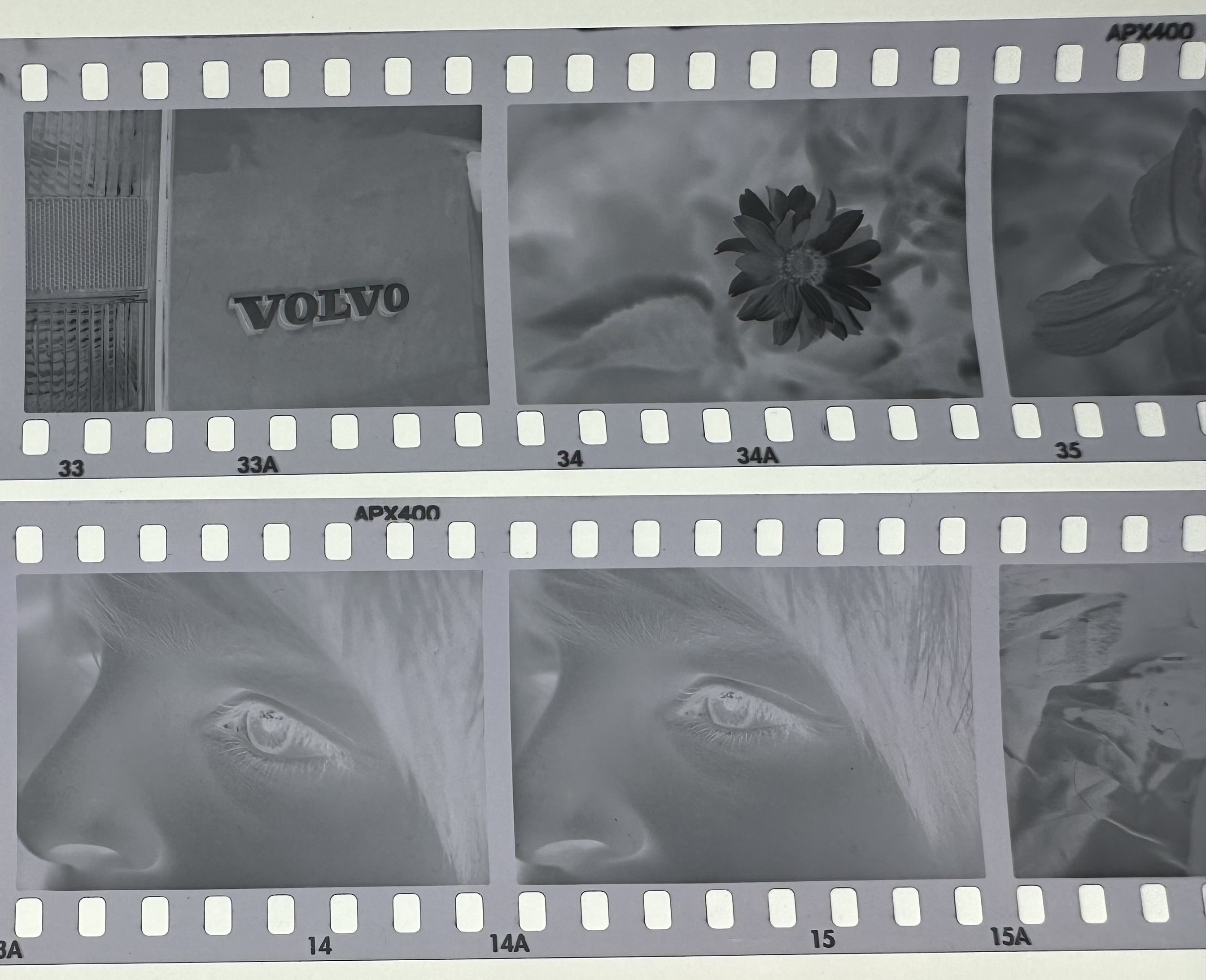

Thanks. The negative is underexposed, but I’m not sure I think it’s overdeveloped?
In general it's not, but I do notice an increase in density towards the bottom of the frames 14,14A,15.
Do you remember how this roll was sitting in the tank? If the bottom side was at the bottom of the tank while the tank was in its resting position during development, then perhaps that increased density is linked to developer gradients that formed due to lack of agitation.

In general it's not, but I do notice an increase in density towards the bottom of the frames 14,14A,15, in all three frames you show.
No, I have no idea how it sat in the tank :smile:
I can check the rest of the roll when I get back home, to see if it’s consistent. I’ve found that I get better results with Rodinal 1:50, with slightly less agitation, and slightly longer time than what’s specified. Whenever I agitate as you describe I seem to get larger and uglier grain.
Probably due to the geography of the face. You're seeing probably just a little more light on the upper curve of the cheek where the cheekbone protrudes. With a dominant light source that's a little higher than eye-level, it's to be expected that that area of the face will be lit more strongly.
I don't see uneven development in those frames. I do see significant underexposure.
Quite contrasty.
Well, yeah. A bit what you'd expect from a 400-speed film underexposed by 2 stops in a developer that doesn't favor shadow detail. Lots of open space with no detail at all. If that's OK for you, then go for it. It's not a tonality I personally prefer in my negatives. If I want harsh images, I can always achieve that in digital post or the printing process. If it's (not) in the negative, there's no choice.

I see what you mean, but I think it's a fluke, really. Note that it's absent from the top roll. I think it has something to do with the photograph of the film strip more than development.
I do agree though that stand development is tricky. Sometimes you get away with it, often not so much. I've never had that much luck with it.
Overdeloped would have very dark hihghlights (the flower e.g.)
These are well developed with good details. If you placed those negs on top of a book and you could see black letters through the darkest areas.
